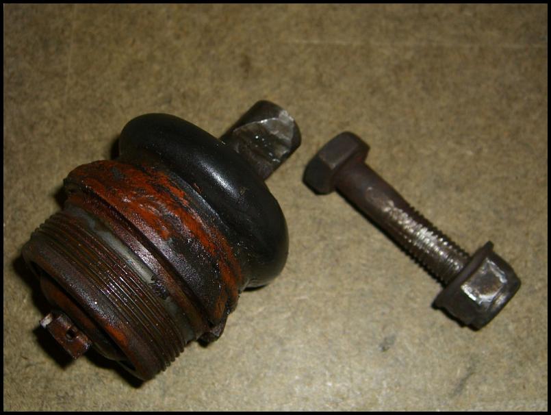

Here tis. You can see how the slot on the joint is all efed up and the bolt is also bent and trashed. Guessing this is why there was so much slop on that side? Anyway, it is an early type, right? Porsche 911 up to 1971? Still...that number on the bellows seems weird. Is that where they put the numbers on a BJ?

kenshapiro2002   Here tis. You can see how the slot on the joint is...   May 20 2010, 09:21 AM
detoxcowboy   Lemfroeder Ball Joints and new Pins, You can get b...   May 20 2010, 09:32 AM
Cap'n Krusty   Look at the first picture. Does that look like a ...   May 20 2010, 09:57 AM

Cap'n Krusty   That's damage from the shaft of the ball joint...   May 25 2010, 09:26 AM
Dr Evil   Its obvious that the guy had no idea what he was d...   May 25 2010, 09:54 AM
