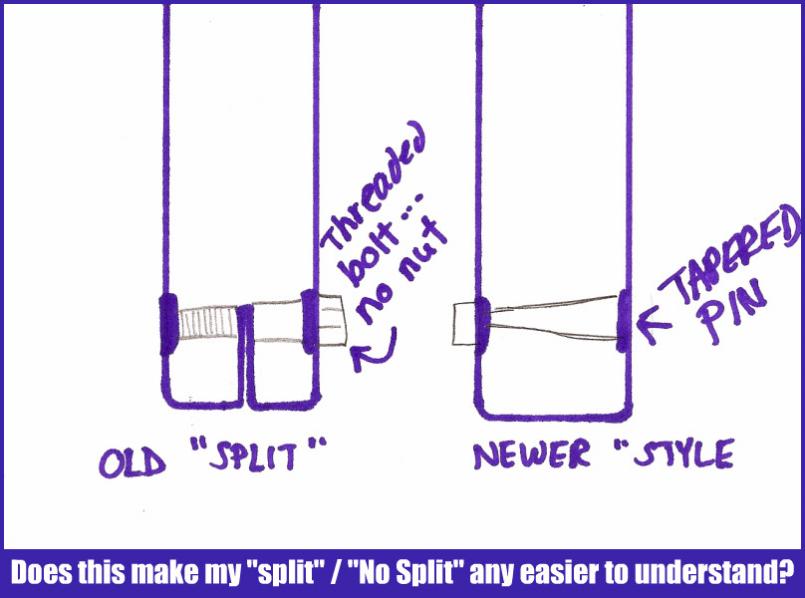

kenshapiro2002   Now I'm really confused...I thought the strut ...   May 25 2010, 10:00 AM
kenshapiro2002   On my right side...with the tapered pin and no spl...   May 25 2010, 10:24 AM
Dr Evil   I was referring to the ball joints and fasteners b...   May 25 2010, 10:50 AM
kenshapiro2002   So...my strut on the right side...the one that had...   May 25 2010, 11:22 AM

kenshapiro2002   Makes sense. Still wondering why my right side...n...   May 25 2010, 12:32 PM
Dr Evil   The new style strut housing had the wrong fastener...   May 25 2010, 04:19 PM
kenshapiro2002   Alright...tried to call you but you were gone...ho...   May 25 2010, 04:39 PM

jaxdream   Yes that is probably your solution but do check th...   May 25 2010, 08:22 PM
kenshapiro2002   Thanks again...a new strut will eventually be happ...   May 26 2010, 04:57 AM
Dr Evil   It looks like my recollection of hole size in the ...   May 29 2010, 02:47 PM
kenshapiro2002   Cool...back out to finish up the job. I've wai...   May 29 2010, 02:59 PM
