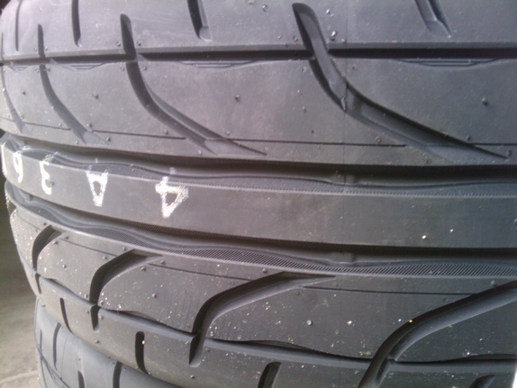

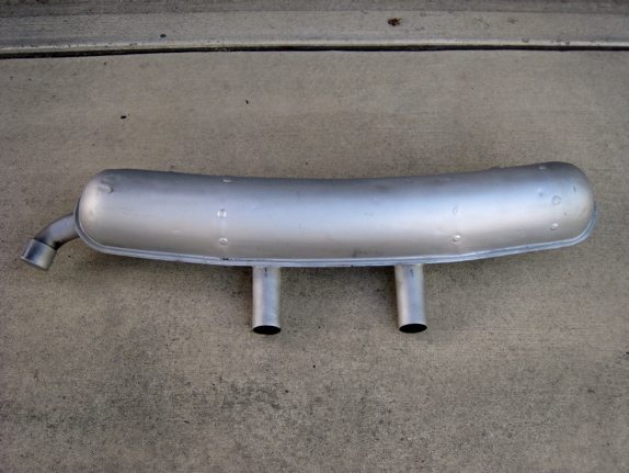

tires have arrived and a muffler that I have been wanting has become available so I will only have to do some tidying up instead of hacking a virgin stock muffler (IMG:style_emoticons/default/biggrin.gif)
I will be removing the stock exhaust pipe, since I want a true twin pipe instead of the vintage rallye 3 pipe look. There are a few holes that need to be repaired but nothing major.
Polished stainless pipes that are about 2 inches longer will be installed also.
Entire muffler will be bead blasted, repairs done and then painted to match the heat exchangers.
