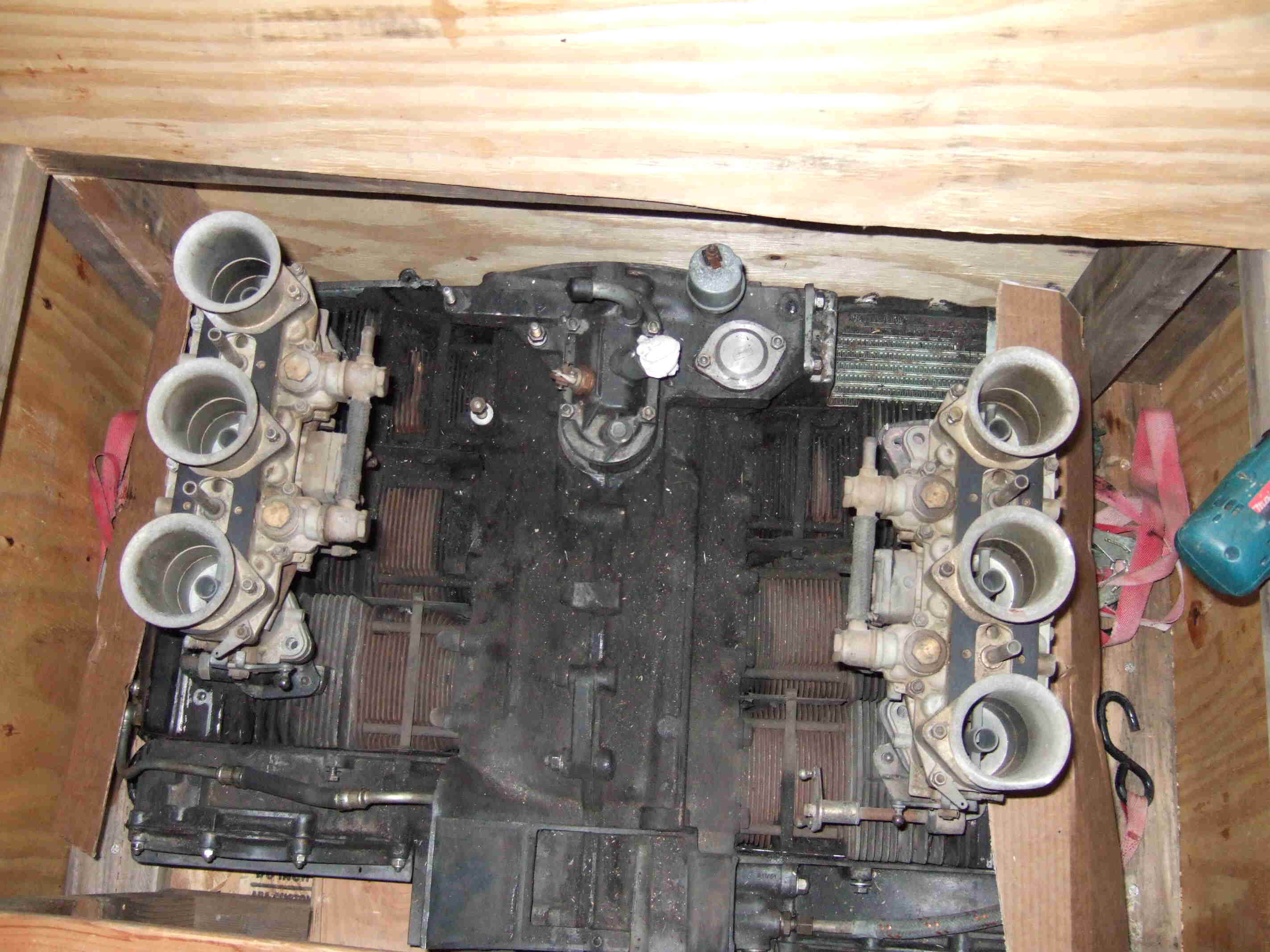

jmill   Look what showed up today. Thanks Jason. It was ...   Jun 3 2010, 08:25 PM
jasons   Look what showed up today. Thanks Jason. It was...   Jun 3 2010, 10:19 PM

effutuo101   Nice! keep up the good work! I am looking ...   Jun 3 2010, 10:02 PM
rick 918-S   That's going to work out really good! :hea...   Jun 3 2010, 10:46 PM
