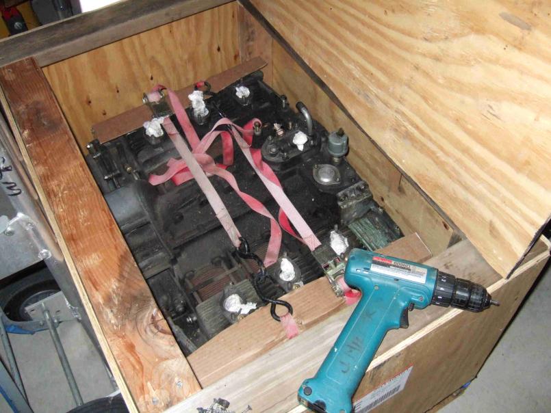

Look what showed up today. Thanks Jason. It was packed bullet proof. The carbs didn't come with it but I had to toss them on as soon as I cracked the crate open. It seems the 2.4 conversion is going to be a reality. All I need now is a shroud, fan, alt, dizzy, linkage, oil tank, oil lines, motor mount and exhaust. Oh, and then about 8k to rebuilt the engine to S spec. (IMG:style_emoticons/default/blink.gif)
I'm thinking of keeping it a T for awhile to cut those costs way down. Let me know if anyone is giving away a set of 2.2S pistons. (IMG:style_emoticons/default/santa_smiley.gif)

QUOTE(jmill @ Jun 3 2010, 07:25 PM) *
Good. I was wondering if you got it yet. Do you know what day it arrived in Milwaukee? Forward Air worked out great.
