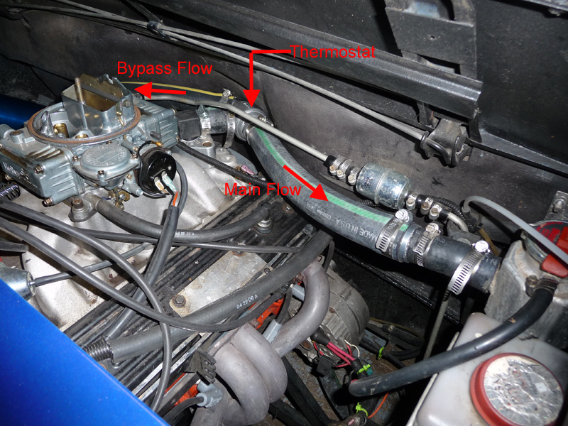

The Renegade system thermostat with bypass is now installed and operating.
The Wahler thermostat is for a BMW 2002 or 320i. (W0133-1627641 80 deg C / 176 deg F, W0133-1627306 75 deg C / 167 deg F, W0133-1622197 71 def C / 160 deg F)
The thermostat installation is pretty tight at the rear firewall, especially if you still have the acoustic pad. You could probably come up with a different water outlet that will give you more room.
The system vented fairly easily and was pretty mcuh free of air after 3 or 4 runs.
The coolant warms up to operating temperature twice as fast as before. I didn't expect this at all. It must be because the small holes I drilled into the original thermostat for promoting venting and some flow during cold conditions let through some water which ran through the radiator and was cooled. Anyway - a benefit.
Everything works as expected, but we have not had any really warm weather to give the bypass thermostat and new water pump a serious test.

nick mironov   The Renegade system thermostat with bypass is now ...   Jun 6 2010, 10:54 AM

nick mironov   The only problem I had was that the Renegade ...   Jun 6 2010, 10:58 AM
