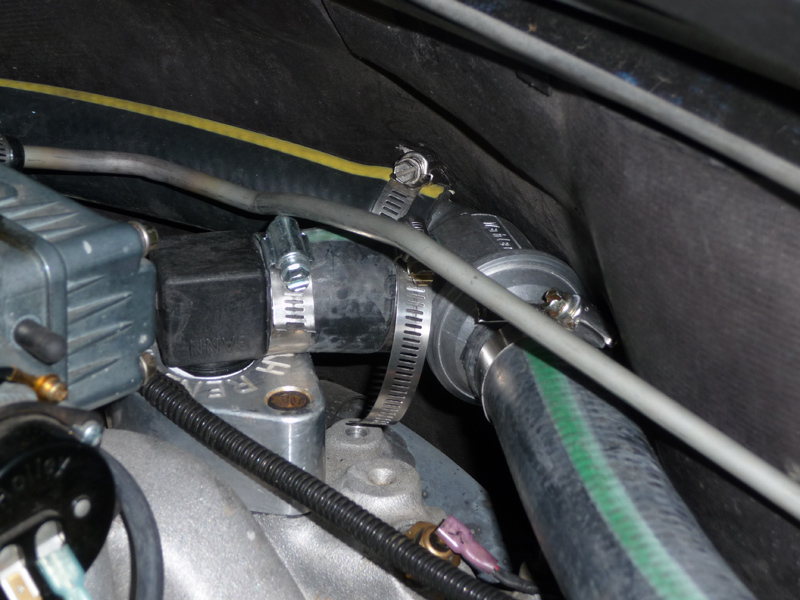

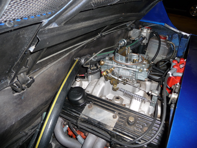

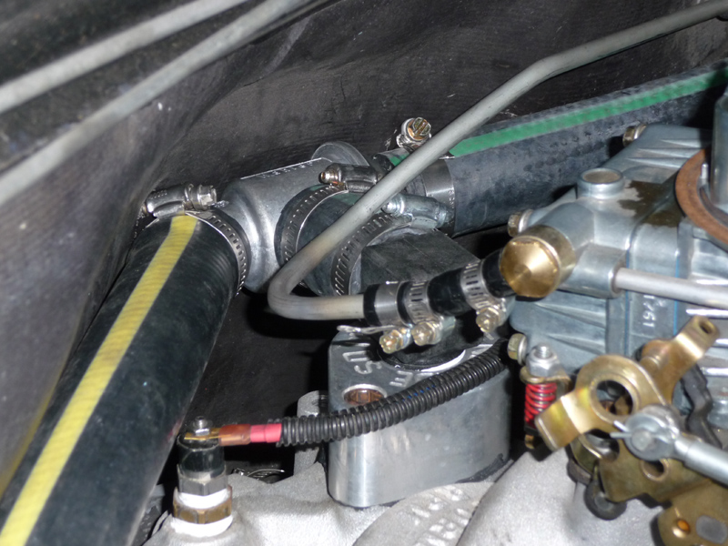

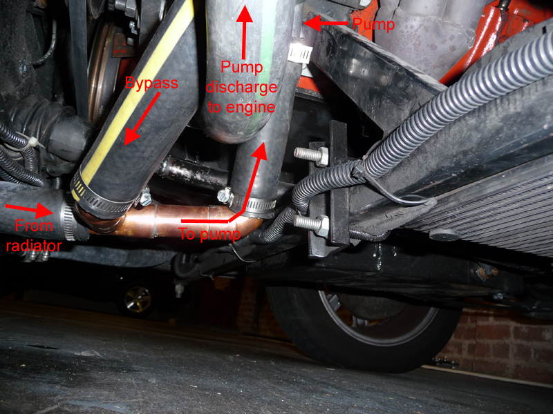

nick mironov   The Renegade system thermostat with bypass is now ...   Jun 6 2010, 10:54 AM
nick mironov   RE: SBC V8 Water Pump Failure   Jun 6 2010, 10:55 AM
nick mironov   RE: SBC V8 Water Pump Failure   Jun 6 2010, 10:56 AM
nick mironov   The only problem I had was that the Renegade ...   Jun 6 2010, 10:58 AM
nick mironov   RE: SBC V8 Water Pump Failure   Jun 6 2010, 10:59 AM
