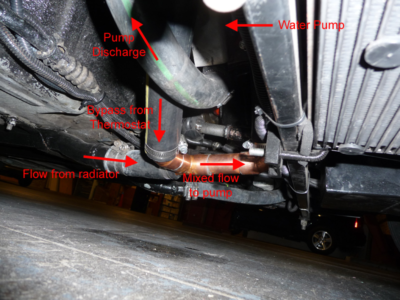

The only problem I had was that the Renegade "Y" fittinng would not fit into the space I had available (probably because I have pipe inder the car instead of hoses). So, I soldered together a 1" copper "T" fitting and got the exact angles I needed so that the hoses were not kinked.

nick mironov   The Renegade system thermostat with bypass is now ...   Jun 6 2010, 10:54 AM
nick mironov   RE: SBC V8 Water Pump Failure   Jun 6 2010, 10:55 AM
nick mironov   RE: SBC V8 Water Pump Failure   Jun 6 2010, 10:56 AM
nick mironov   The only problem I had was that the Renegade ...   Jun 6 2010, 10:58 AM
nick mironov   RE: SBC V8 Water Pump Failure   Jun 6 2010, 10:59 AM
