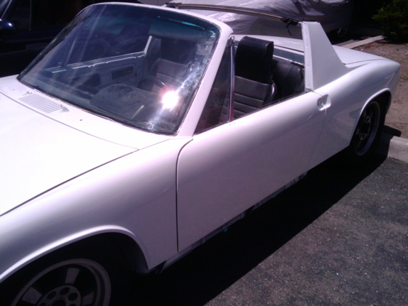

DanT   got the word this afternoon that the major body pa...   Jun 8 2010, 07:34 PM
DanT   now the real reassembly can begin.... :trophy:   Jun 13 2010, 03:34 PM

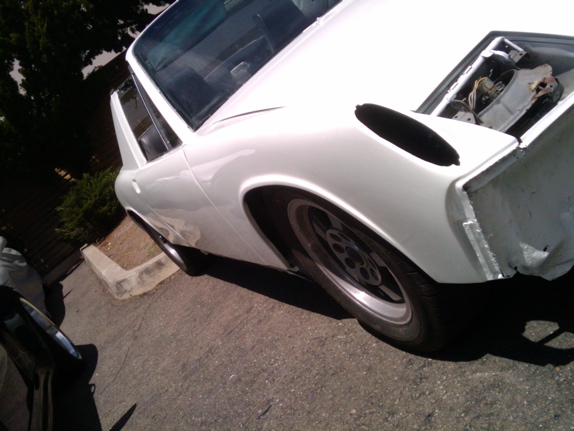

DanT   new tire/wheel combination installed. It is amazi...   Jun 14 2010, 04:49 PM
Root_Werks   That's looking really nice Dan! The fuchs...   Jun 15 2010, 09:04 AM
DanT   Factory.... my spacing issue is in the rear. Insi...   Jun 15 2010, 09:07 AM
