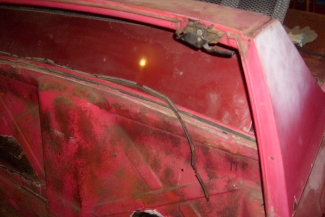

Here's another example of the amount of heat this car was exposed to. The engine lid seal turned into a chunk of brittle plastic and shattered and splintered as I tried to remove it. All the rubber has some amount of the same condition.
