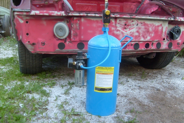

I bought a new tool today. I went to Harbor Freight and picked up a soda blaster. My goal is to strip the interior surfaces of the repaint. I am trying to leave the factory color or as much of it as I can anyway. I know I can paint over the factory color but I don't know what the second paint job is. It looks like a base/clear job. If it's an early base coat it will likely shrivel when painted over. I can strip the outside body panels in a day but the inside surfaces are harder to do. Often the prep work for a repaint is little more than a quick sand with a skuff pad. The soda blaster is working nicely. its doing a nice job but slow going.
