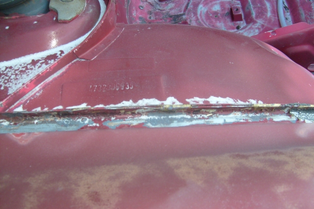

As I was stripping things off the car I discovered the right fender had been replaced. This was done early enough in the cars life that the entire fender was done. Who ever did the work did a nice job with the exception of the brass they used to weld it on. It's lucky this car was a west coast car all it's life or the braising would have been the kiss of death. I will likely just sand blast the channel and the entire inside mounting surface where the fender was joined to the car. With proper metal conditioning, priming and seam sealer (which there is none of now...) the car will be unaffected by the repair. I was suprised to see the lack of rust where the fender was attached and the seam sealer was not replaced on the inside wheel house.

jasons   As I was stripping things off the car I discovere...   Jun 18 2010, 11:26 PM
rick 918-S   As I was stripping things off the car I discover...   Jun 18 2010, 11:41 PM
