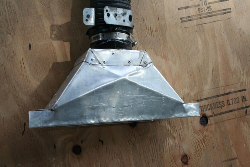

carr914   Here is a shroud I made for a front cooler (didn...   Jun 23 2010, 11:05 AM

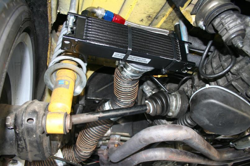

tat2dphreak   I don't have pics, but I installed a 96-plate ...   Jun 29 2010, 09:59 AM
jhadler   I don't have pics, but I installed a 96-plate...   Jun 29 2010, 01:05 PM
tat2dphreak   near the tranny, but, unlike the one above(post #1...   Jun 29 2010, 02:36 PM
tat2dphreak   went out and snapped a couple pics...   Jun 29 2010, 05:45 PM

tat2dphreak   I am getting clooser to installing my oil cooler....   Jun 30 2010, 09:10 AM
