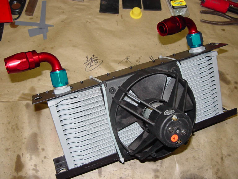

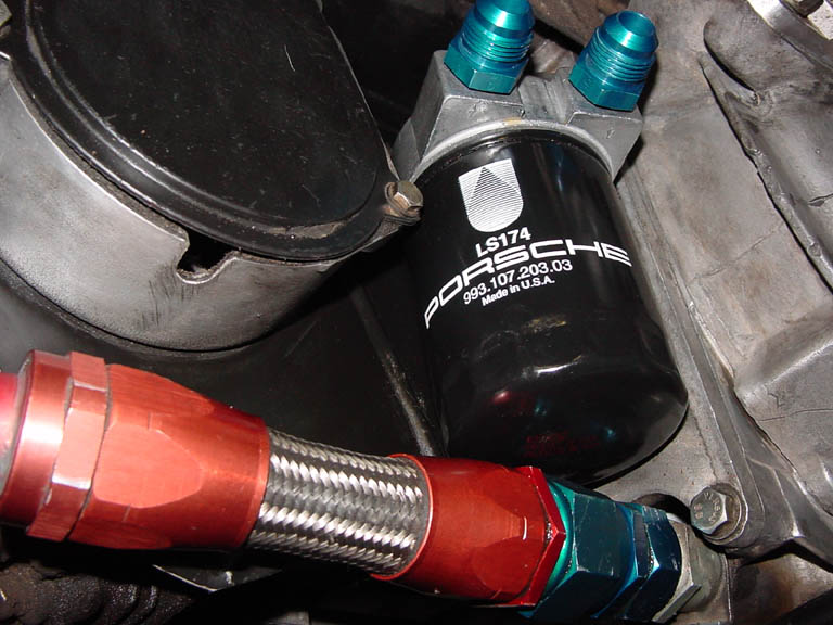

What engine? Is this the small filter behind cylinder #6, the stock filter on a six, or are we talkin' a four cylinder car? Perhaps there's something useful here in any event. As you can see the 993 doesn't have a console mounted cooler like earlier motors. Instead there's a small filter there. Mocal thermostat...
Note: I took off the fan BTW. It cools just fine by convection.
Note: This is an auxiliary cooler. The main cooler is front mounted. The original Earl's cooler (above) sprung a leak (7 yrs later) so I replaced it with a B&N cooler with slightly better BTU removal.
More light...
I'm about to add a transaxle oil cooler behind this one in a couple of weeks so I'll have to add a fan to do them both. I've used -10 plumbing. The trans cooler will use -8. Hope that helps.
Good Luck!
