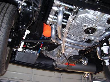

Here's my set-up: Full flow oil, remote filter, by-pass thermostat and simple oil cooler. It all sits on the right side of the transmission since the left side is taken up by the Tangerine exhaust. It's only for street use but I've never seen the oil temperature exceed 2/3 scale on the gauge. That was on a 90+ degree day, stop & go traffic. It's never exceeded half-scale under full load pulling steep hills on the same 90 degree day. The next step would be to add a draw through fan if I needed to. Normally the oil temp gauge runs well below the middle.

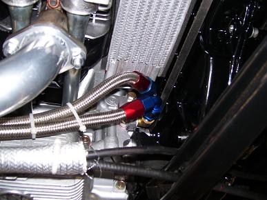

Elliot Cannon   Cooler under left side of trunk. I have a very lo...   Jun 22 2010, 11:52 AM
Elliot Cannon   more pics   Jun 22 2010, 11:54 AM

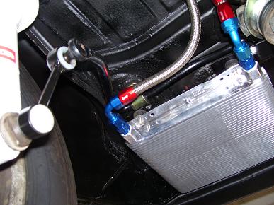

tradisrad   Oil cooler is installed. I mounted it under the re...   Jul 11 2010, 10:21 AM

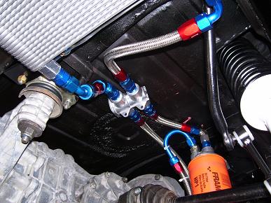

brant   finally doing my install today of the atomic deral...   Sep 18 2010, 10:52 AM
tradisrad   Brant, I hope this will help. Let me know if I can...   Sep 18 2010, 01:23 PM

qa1142   Very smart hose routing :first: Any pictures ne...   Sep 18 2010, 04:59 PM
qa1142   Very smart hose routing :first: Any pictures ne...   Sep 18 2010, 05:01 PM
tradisrad   Very smart hose routing :first: Any pictures n...   Sep 18 2010, 05:13 PM
qa1142   I purchased blue hose to do my install with, I lik...   Sep 18 2010, 05:18 PM
tradisrad   The hose is Nylon Braided AN Hose. This hose size ...   Sep 18 2010, 07:59 PM
