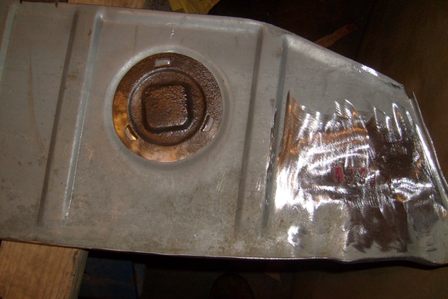

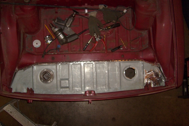

I worked on the trunk floor repair panel. I decided to cut out the holes for access caps to give the trunk a factory look. This is not nessesary as these are really only used for access for the factory spot welders.

QUOTE(rick 918-S @ Jun 28 2010, 02:42 AM) *
I reasoned the holes were for fluid flow when they dipped the chassis in paint.
post Jun 28 2010, 02:18 PM
Resident German
Posts: 42,560
Joined: 21-January 03
From: Oakland, Kalifornia
Member No.: 179
QUOTE(9146986 @ Jun 28 2010, 12:07 PM) *
And since they didn't dip the chassis in paint, i think the spot welders is the better choice ...

rick 918-S   I worked on the trunk floor repair panel. I decide...   Jun 28 2010, 04:42 AM

rick 918-S   If you notice there is a dimple on the edge of the...   Jun 28 2010, 04:49 AM

rick 918-S   No dipping as far as I know or we wouldn't be ...   Jun 28 2010, 02:54 PM
McMark   They were dipped in primer, but the paint was spra...   Jun 28 2010, 06:27 PM
