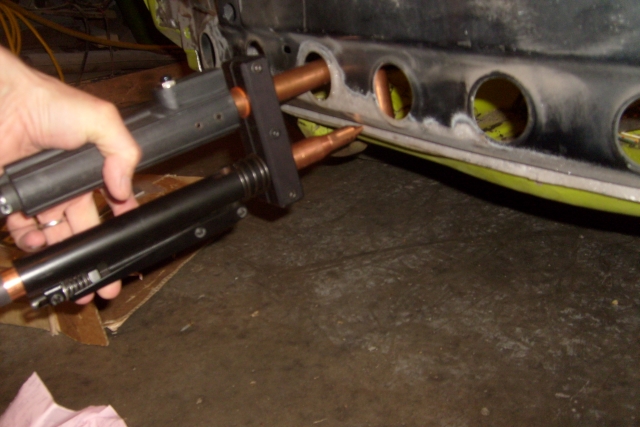

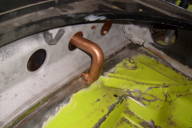

rick 918-S   I bought a new tool today. I went to Harbor Freigh...   Jun 18 2010, 07:45 PM
