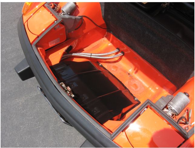

A member on club was/is selling their ride on ebay, and they had this pic of a very nicely installed front-mounted oil cooler. Not sure if it's full flow or not.
Here's the listing (no affiliation):
http://www.914club.com/bbs2/index.php?showtopic=214924
