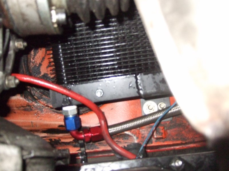

went out and snapped a couple pics...

tat2dphreak   I don't have pics, but I installed a 96-plate ...   Jun 29 2010, 09:59 AM
jhadler   I don't have pics, but I installed a 96-plate...   Jun 29 2010, 01:05 PM
tat2dphreak   near the tranny, but, unlike the one above(post #1...   Jun 29 2010, 02:36 PM
tat2dphreak   went out and snapped a couple pics...   Jun 29 2010, 05:45 PM

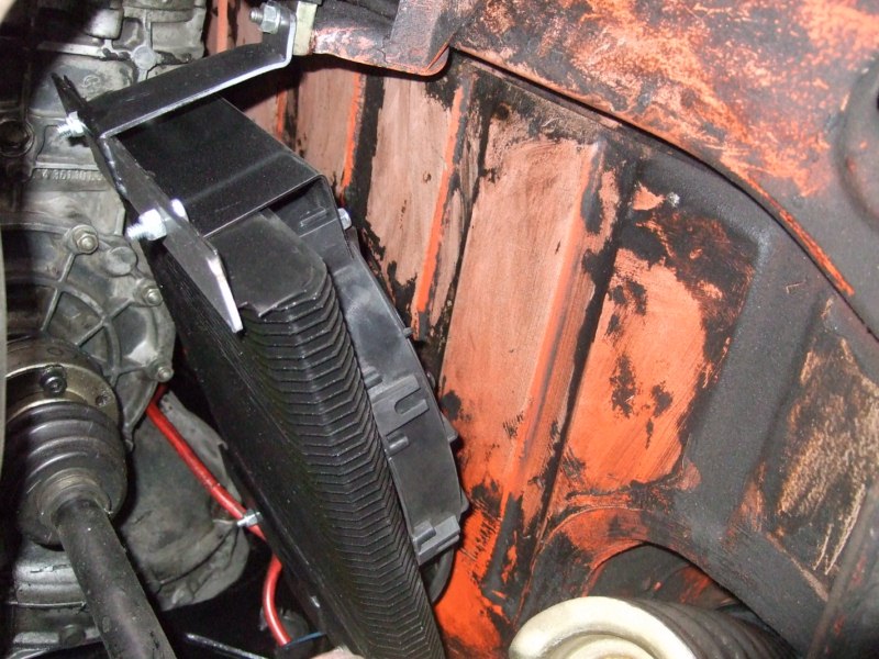

naro914   For Papa Smurf, we have the cooler mounted to the ...   Jun 30 2010, 12:02 PM

tradisrad   Oil cooler is installed. I mounted it under the re...   Jul 11 2010, 10:21 AM
