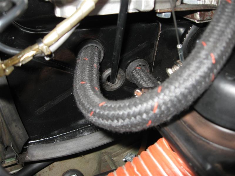

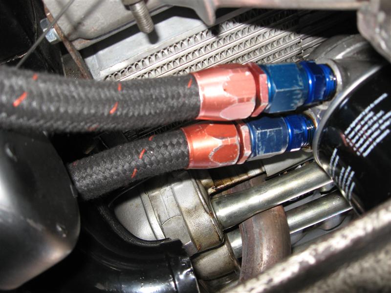

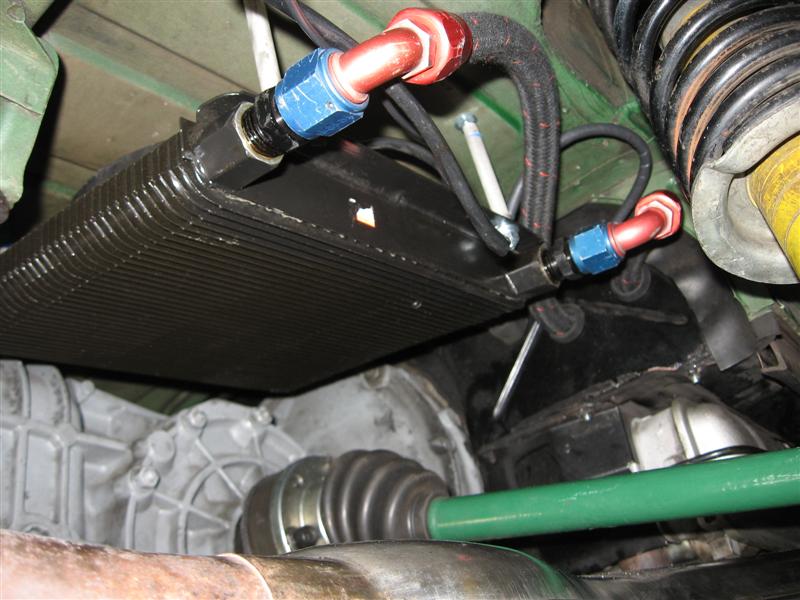

Oil cooler is installed. I mounted it under the rear trunk, ran the cooler lines through the engine compartment, added a thermostaticly controlled fan.
I am able to keep my oil temps down around 180 to 190 with the fan running. I pulled the fan fuse and noticed the temps climb into the 210 range. I am pleased with the outcome.
Oil cooler:
Lines passing into the engine compartment:
Mocal adapter:
