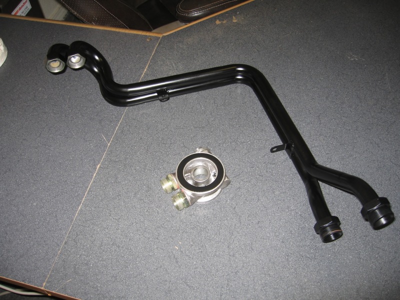

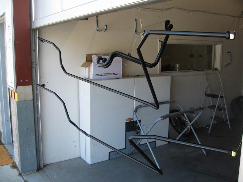

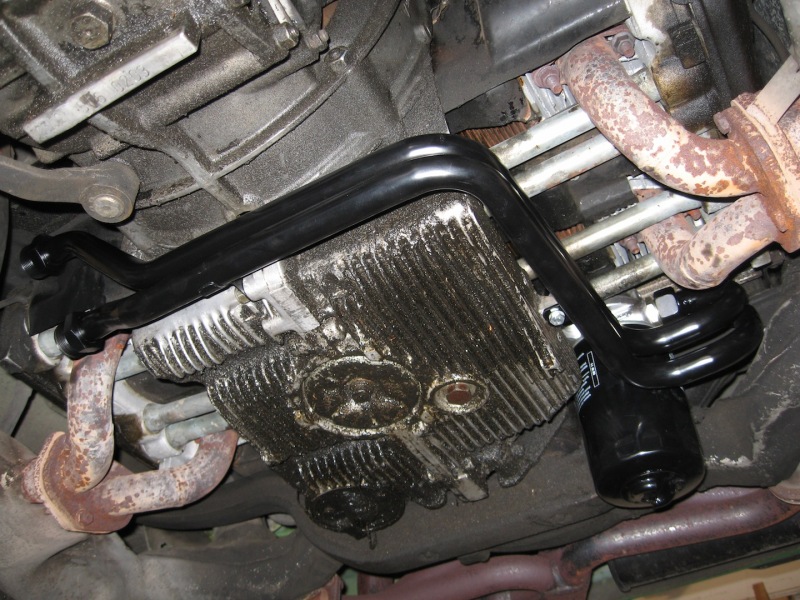

BigD9146gt   Heres a hardline setup I made for a 912E... The cu...   Jul 11 2010, 12:10 PM

gothspeed   Heres a hardline setup I made for a 912E... The c...   Jul 12 2010, 11:22 AM
BigD9146gt   What size thread is that thermostat you used? ...   Jul 12 2010, 12:09 PM
