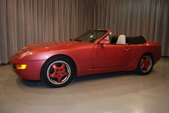

http://cgi.ebay.com/ebaymotors/1993-Porsch...#ht_14881wt_958
(IMG:http://www.914world.com/bbs2/uploads_offsite/1.photos.ebizautos.com-8357-1279163738.1.jpg)
