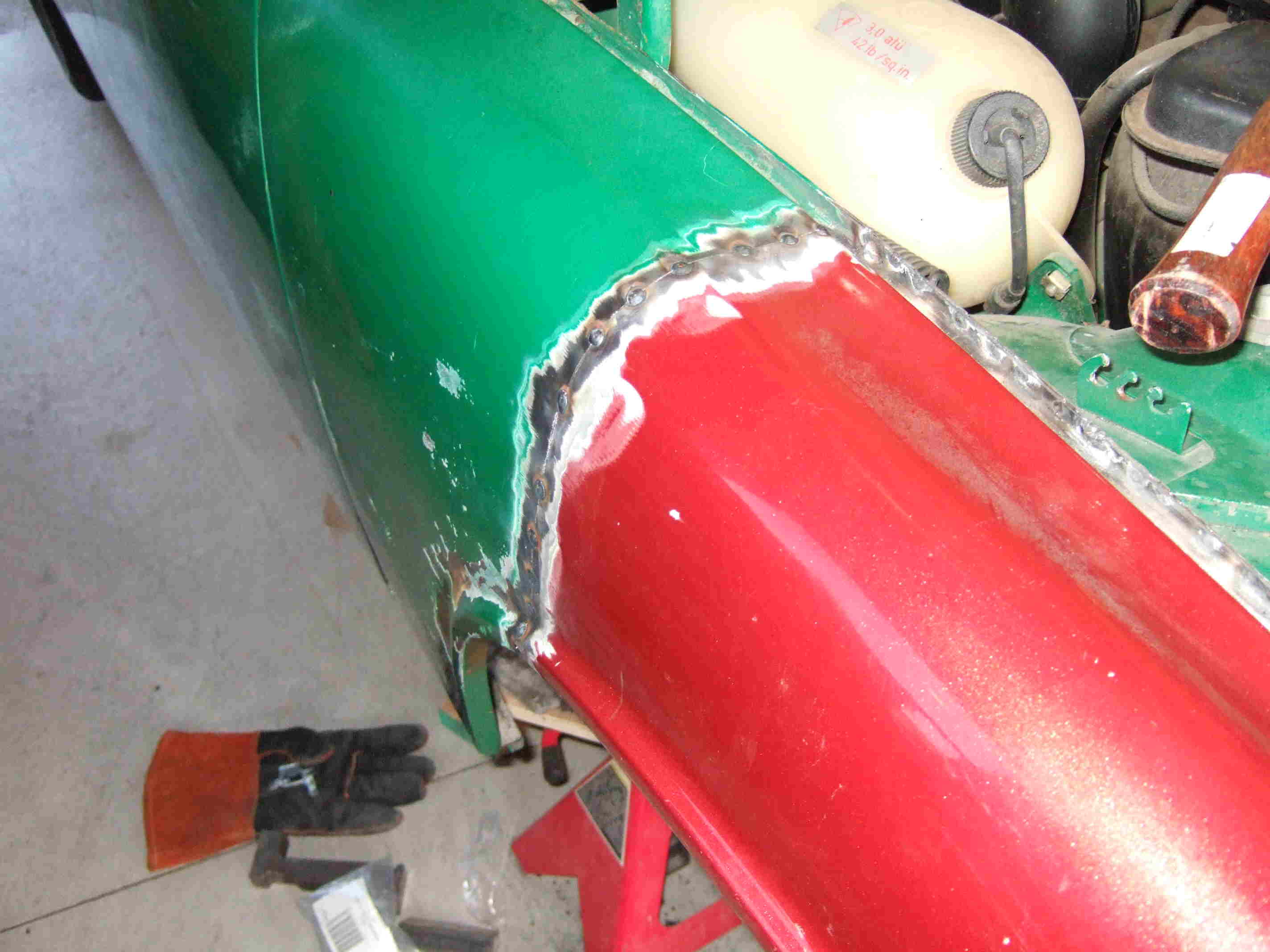

The fender is finally going on. I had to take 4 days of vacation to get one day in the garage. It's funny how you plan to do all kinds of stuff on vacation and then life gets in the way. Some lady backed into the wifes BMW. There went one day chasing estimates and playing phone tag with insurance agents.
Anyhow, it's going on nice. Unfortunately the only rust free fender I had was dented up. After grinding off 1/2" of bondo and some work with a dolly block and hammer it looks pretty good. I'll have to bribe Rick to help me with the body work. I can weld and grind but I can't do bondo. It takes me like 5 coats to get things decent.

jmill   The fender is finally going on. I had to take 4 d...   Jul 17 2010, 08:42 PM
jmill   one more.   Jul 17 2010, 08:44 PM
rick 918-S   I could end up working over in Milwaukee later in ...   Jul 17 2010, 09:09 PM
jmill   Completed butt weld and then blended smooth.   Jul 18 2010, 05:10 PM
jmill   All that work just to chop it out of there and add...   Jul 18 2010, 05:12 PM
jmill   From the backside. You can see the waves in the A...   Jul 18 2010, 05:16 PM
rick 918-S   That butt welded seam came out so nice I bet you h...   Jul 18 2010, 06:42 PM
jmill   That butt welded seam came out so nice I bet you ...   Jul 18 2010, 07:00 PM
