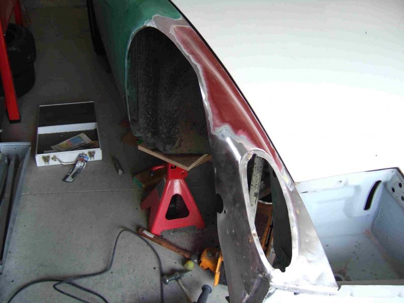

jmill   The fender is finally going on. I had to take 4 d...   Jul 17 2010, 08:42 PM
jmill   one more.   Jul 17 2010, 08:44 PM
rick 918-S   I could end up working over in Milwaukee later in ...   Jul 17 2010, 09:09 PM

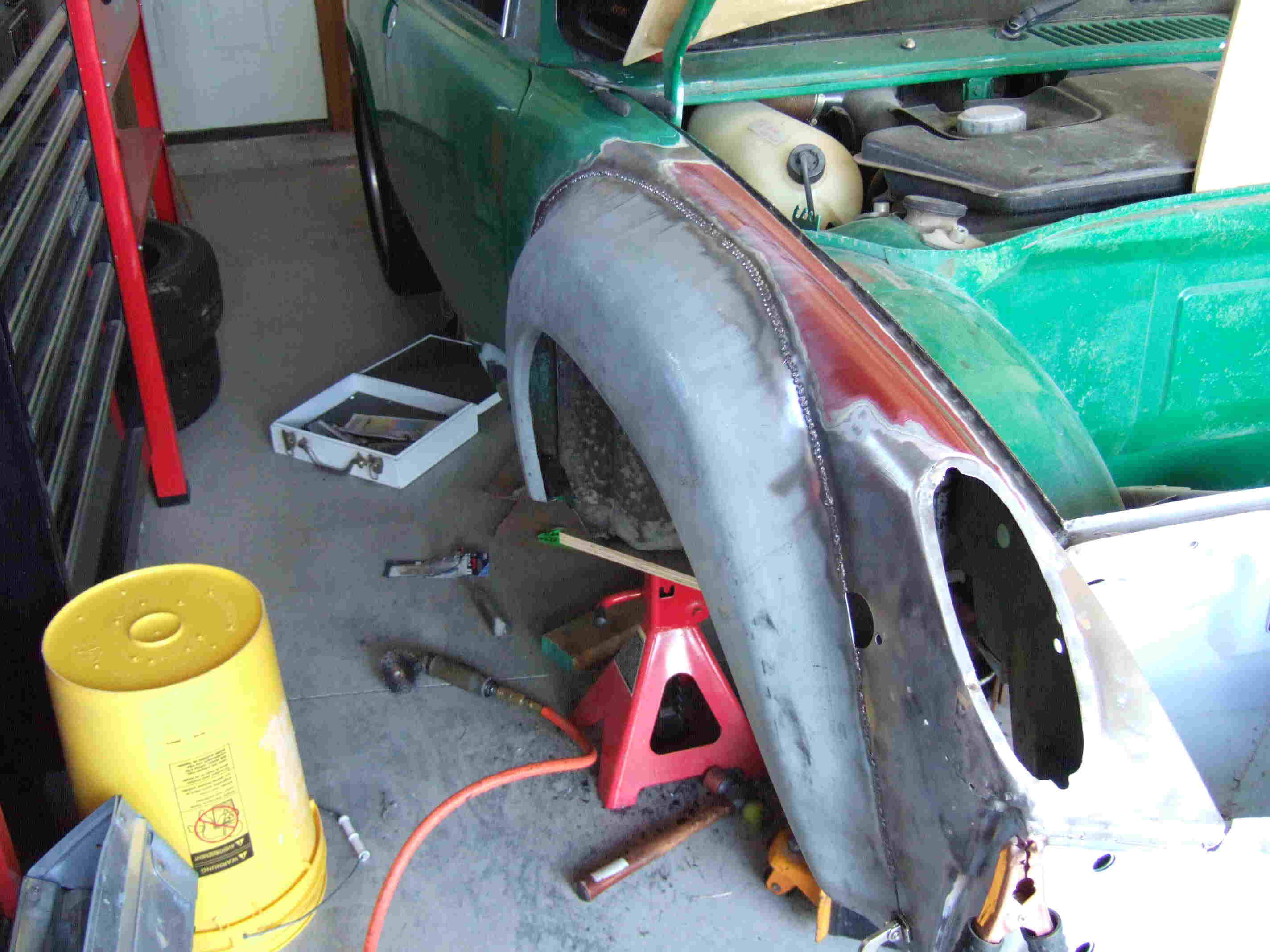

jmill   Completed butt weld and then blended smooth.   Jul 18 2010, 05:10 PM
jmill   All that work just to chop it out of there and add...   Jul 18 2010, 05:12 PM
jmill   From the backside. You can see the waves in the A...   Jul 18 2010, 05:16 PM
rick 918-S   That butt welded seam came out so nice I bet you h...   Jul 18 2010, 06:42 PM
jmill   That butt welded seam came out so nice I bet you ...   Jul 18 2010, 07:00 PM

jmill   Drivers side flare going on.   Jul 25 2010, 02:29 PM
jmill   Going to need some more sanding disks and that bod...   Jul 25 2010, 02:32 PM
jmill   Looking Great man, keep up the good work! ...   Jul 25 2010, 02:40 PM
faux916   Looking Great man, keep up the good work! ...   Jul 25 2010, 03:15 PM
