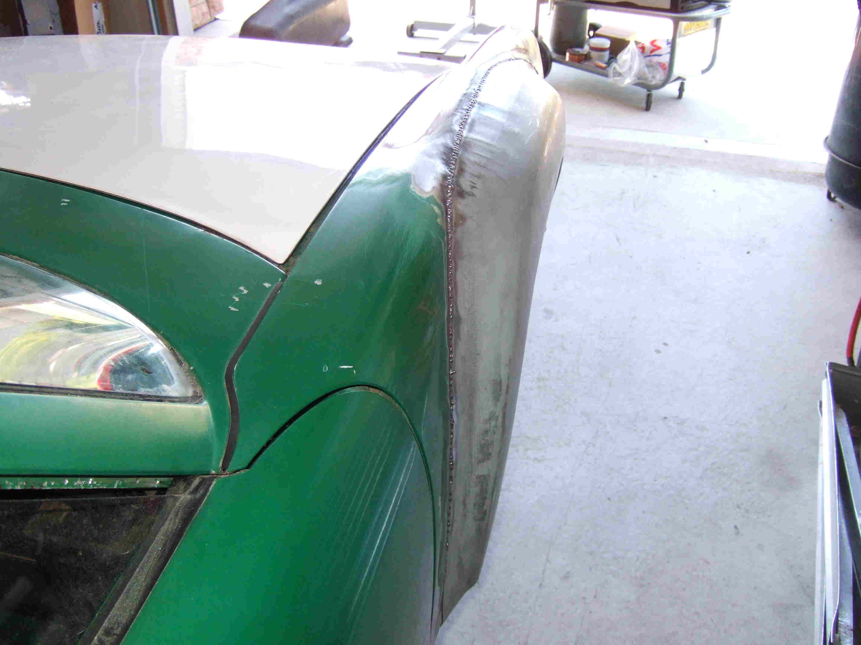

jmill   Completed butt weld and then blended smooth.   Jul 18 2010, 05:10 PM
jmill   All that work just to chop it out of there and add...   Jul 18 2010, 05:12 PM
jmill   From the backside. You can see the waves in the A...   Jul 18 2010, 05:16 PM
rick 918-S   That butt welded seam came out so nice I bet you h...   Jul 18 2010, 06:42 PM
jmill   That butt welded seam came out so nice I bet you ...   Jul 18 2010, 07:00 PM
