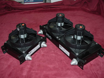

I am going to install my 25 row Earls oil cooler over the 4th of july and I am looking for some more ideas, tip and tricks.
I plan on using a wafer adapter to keep my filter in the stock location. I will also install a thermostat and a fan. I will most likely mount it under the rear trunk.
I'd like to see some pictures of what others have done. Experinces on the wafer adapter vs relocating the oil filter and what thermostats are being used. I've seen the Pelican Article.
thanks
-Rob

This is the cooler that I am using (the bigger one with 2 fans):
(IMG:http://www.914world.com/bbs2/uploads_offsite/www.aircooled.net-1435-1279501692.1.jpg)
I was SUPER impressed with the difference in oil temps today. I fully expected to be running at 220, and that would have been good. I was amazed to see myself running no higher then 205 or so, especially on a hot day.
Zach
