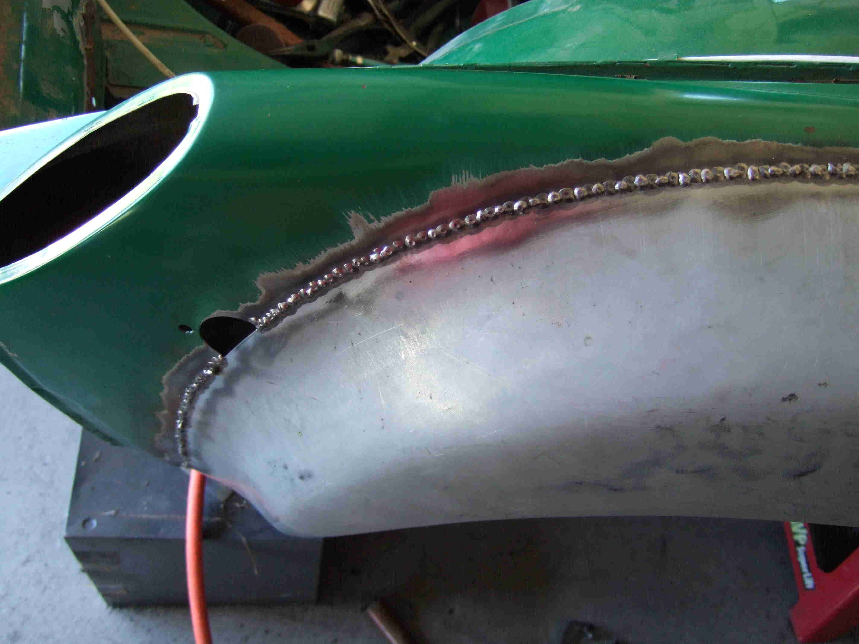

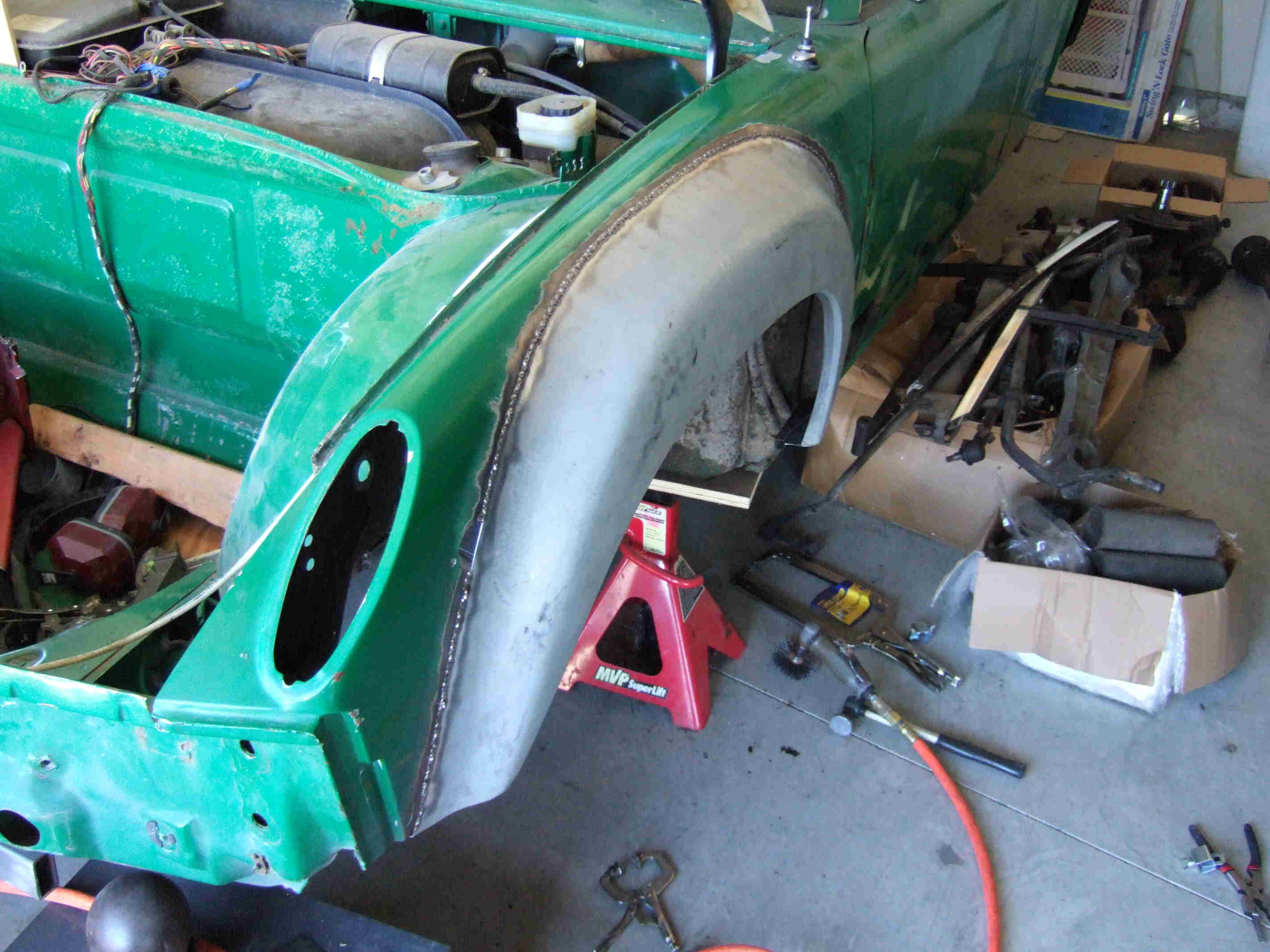

jmill   Drivers side flare going on.   Jul 25 2010, 02:29 PM
jmill   Going to need some more sanding disks and that bod...   Jul 25 2010, 02:32 PM

jmill   Anybody use one of these and will it work on the w...   Jul 25 2010, 02:56 PM
strawman   Anybody use one of these and will it work on the ...   Jul 25 2010, 10:56 PM
jmill   Very nice work...The rockers are different sizes ...   Jul 25 2010, 07:16 PM
rick 918-S   I've never used a shrinking disc. I've alw...   Jul 25 2010, 07:27 PM
