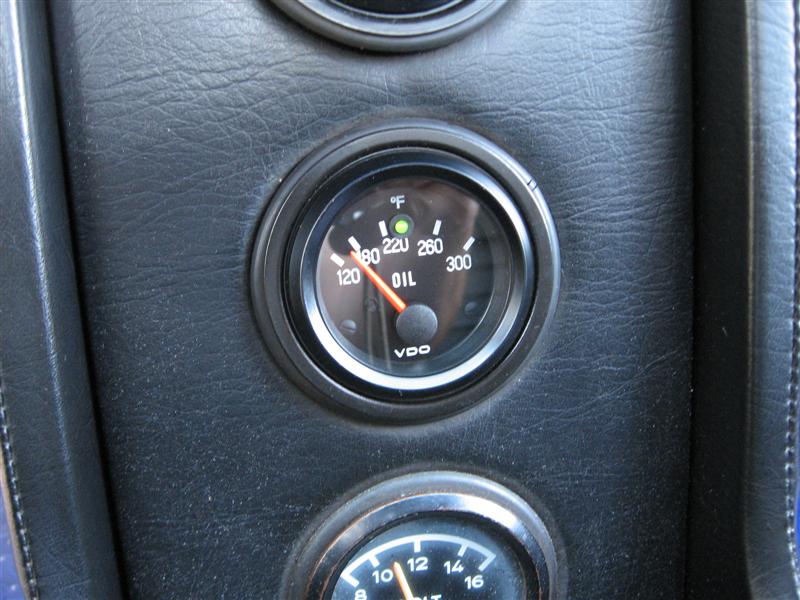

I added an LED to my oil temp gauge to indicate when the oil cooler fan is on. I drilled the led hole a bit low and the light clips the top of the "220", but I don't think it looks too bad (for having limited tools and doing it by hand).
The needle is capable of clearing the LED if it ever gets that hot and it is hard to see when it is off. I also added a variable resistor the the back of the gauge so I can controll the brightness of the LED. Now my oil cooler project is done.

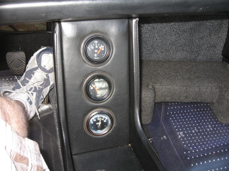

since the oil temps are not getting too hot my oil pressure is staying high. This next picture is on the freeway at 3k rpm. I have been told that the pressure is good and I should be happy, but I guess I need something to worry about because I think it's a bit too high.
