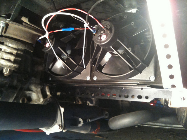

Here is a QUICK picture of my setup.
(IMG:http://www.914world.com/bbs2/uploads_offsite/farm5.static.flickr.com-1435-1280104274.1.jpg)
I was chaing the oil in my wife's car, and the 914 was next to it, so I just rolled over and snapped a quick one of the cooler location. Its a cell phone pic. To show more I have to have time to put the car up in the air. I am going to move it slightly to add a little more room away from teh rear suspension, but the general location will not change.
