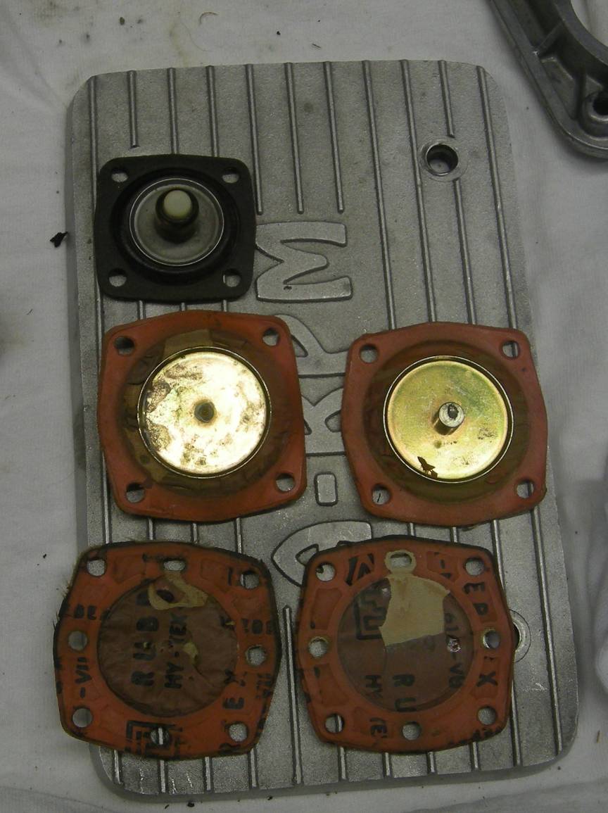

The diaphragms on the 40IDA disintegrated, at first I blamed the Pine-Sol, but taking the other carb apart dry I found they were trashed already . I also don't think they were OE weber anyways. Guess I need new carb kits.
Top is the diaphragm from the DCNF, it was left in Pine-Sol overnight and it's in great shape.
