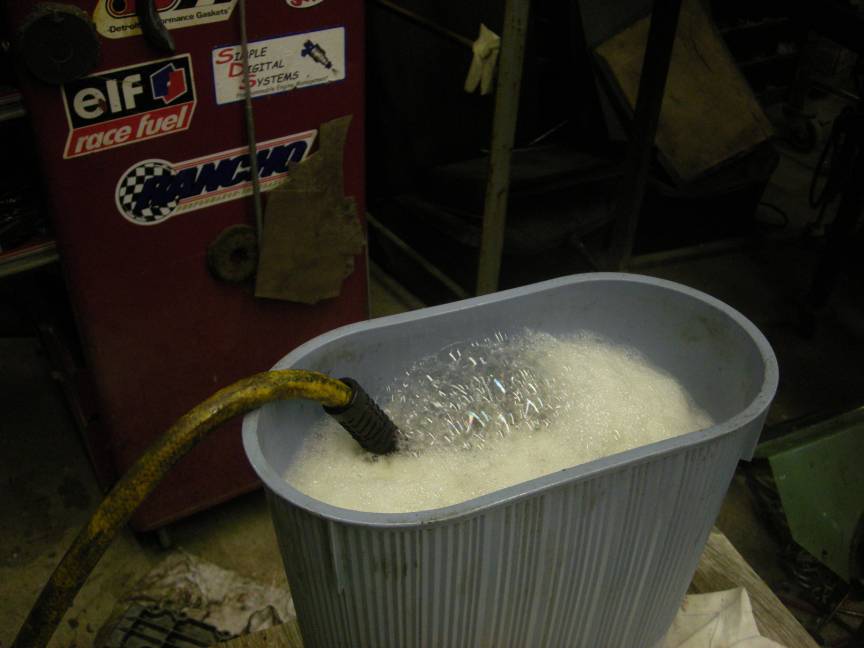

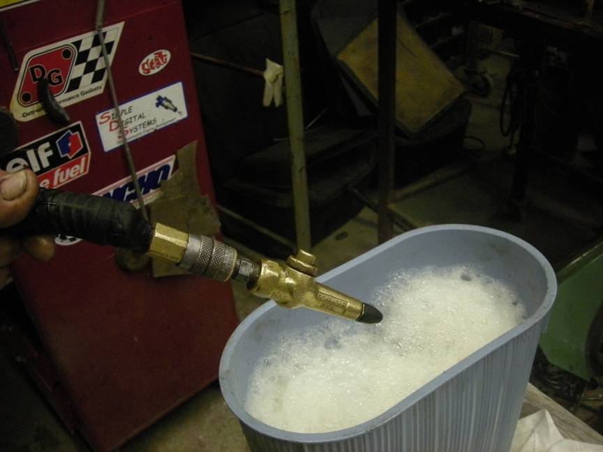

Being the cheap ass that I am...I think I figured out how to get an extra day out of the solution. This blower has a leak, I turned the regulator down to just a trickle and I have bubbles agian. Seems to be working and I wanted to drain the compressor anyways.
