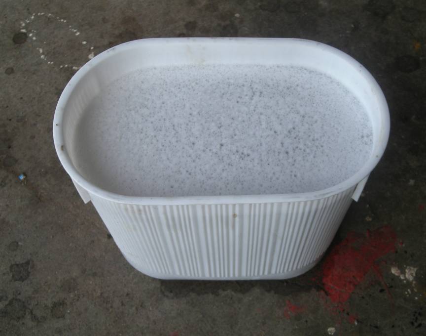

This is my rinse bucket, just clear water. I already had blasted it with water and then dunked the 40IDA body and top. You can get a good idea how much soap is still left on them.
(IMG:style_emoticons/default/huh.gif)
