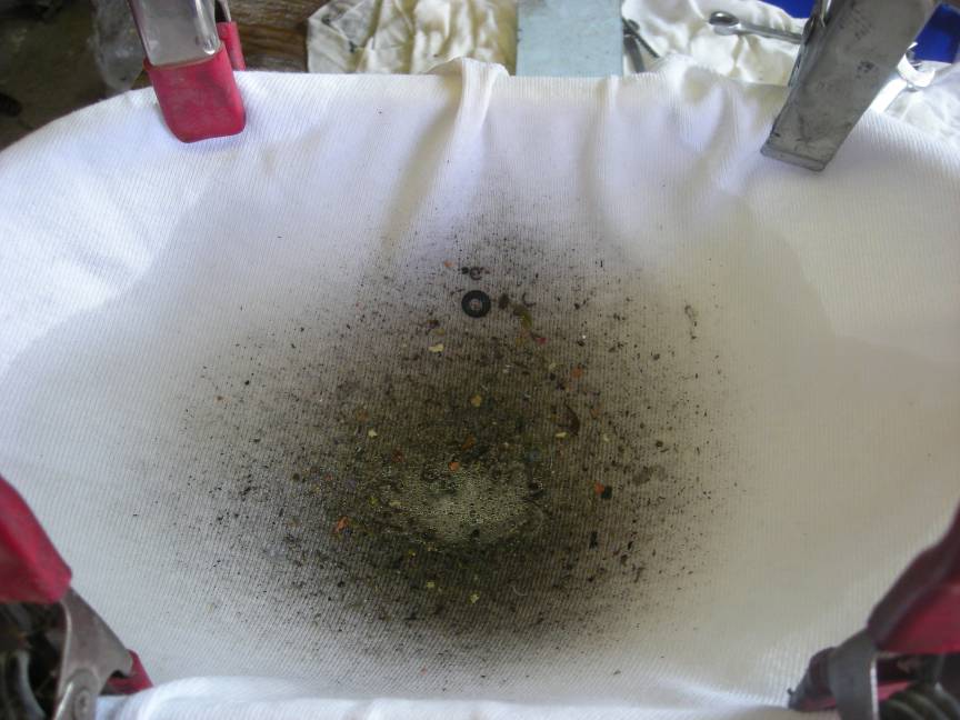

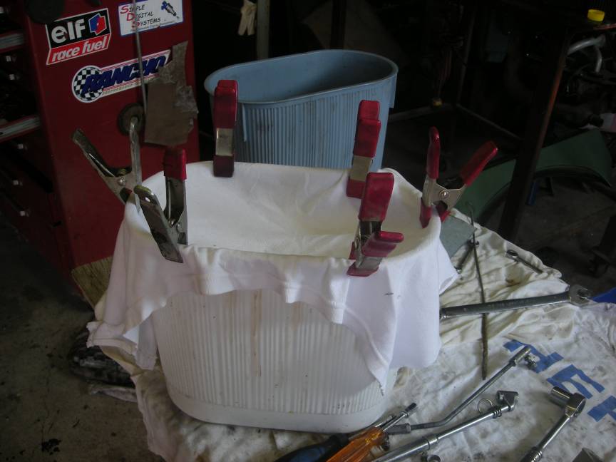

This shows how I filtered the Pine-Sol. A real good idea, not only to keep it clean, but as you can see catch any little parts you may have missed.
