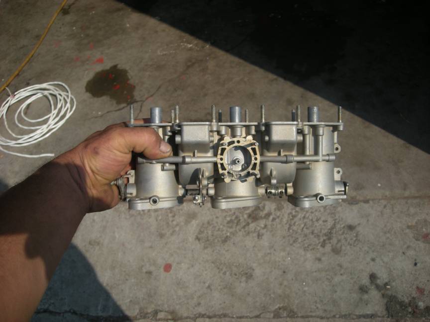

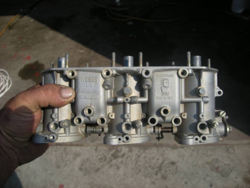

Here is my second 40IDA, the bubbler trick worked, but I think not quite as well as the fresh Pine-Sol. Good enough for me and still better than any carb cleaner I've ever used before.
The amazing part is how well it works in all the nooks and crannies. (IMG:style_emoticons/default/aktion035.gif)
