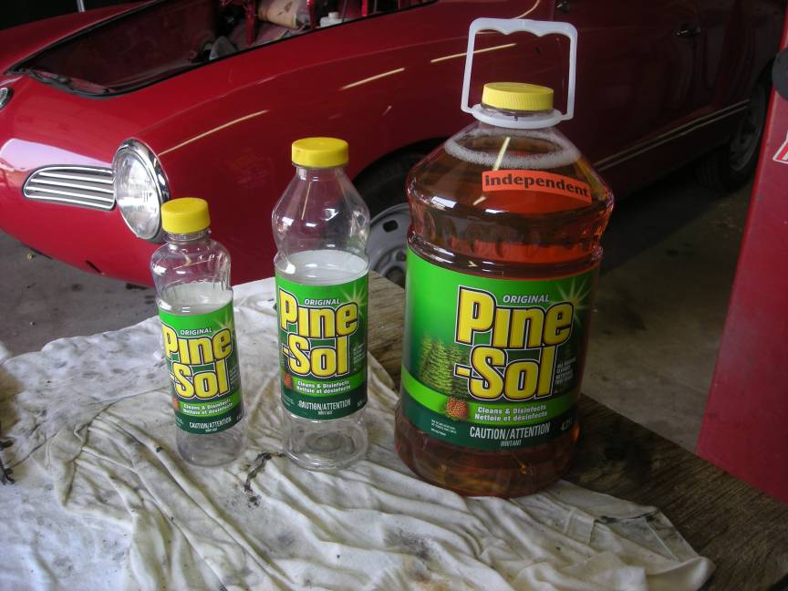

The wife just got me a big bottle of Pine-Sol. Little bottle $1 (dollar store) medium bottle was $4 and the big one was $12.
I'll have to do the math, but I think the little dollar store bottles is the cheapest.
I'm wondering if I should try to recharge the old stuff or just start with new?? (IMG:style_emoticons/default/idea.gif)
