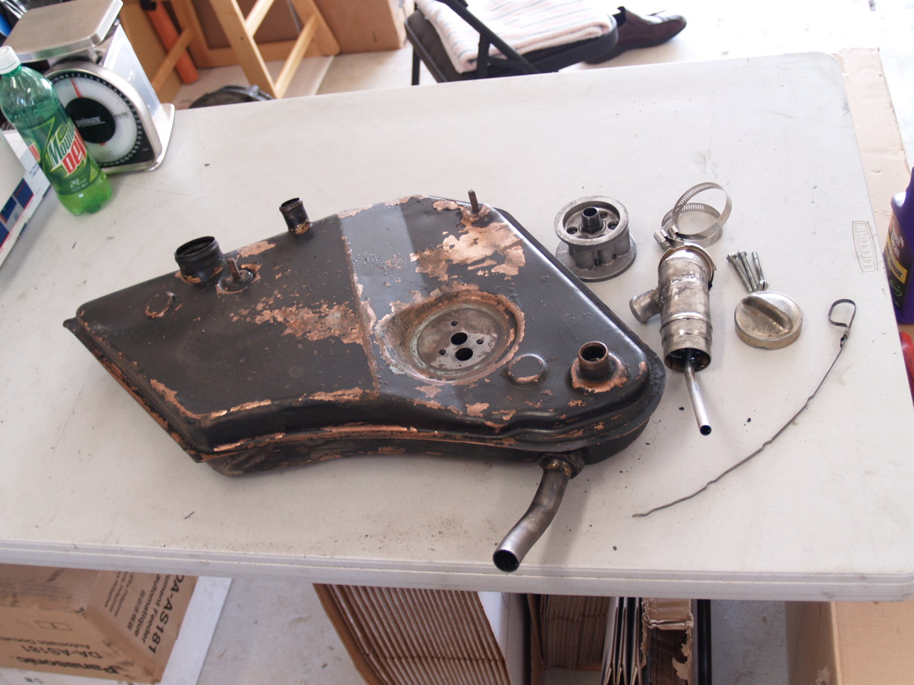

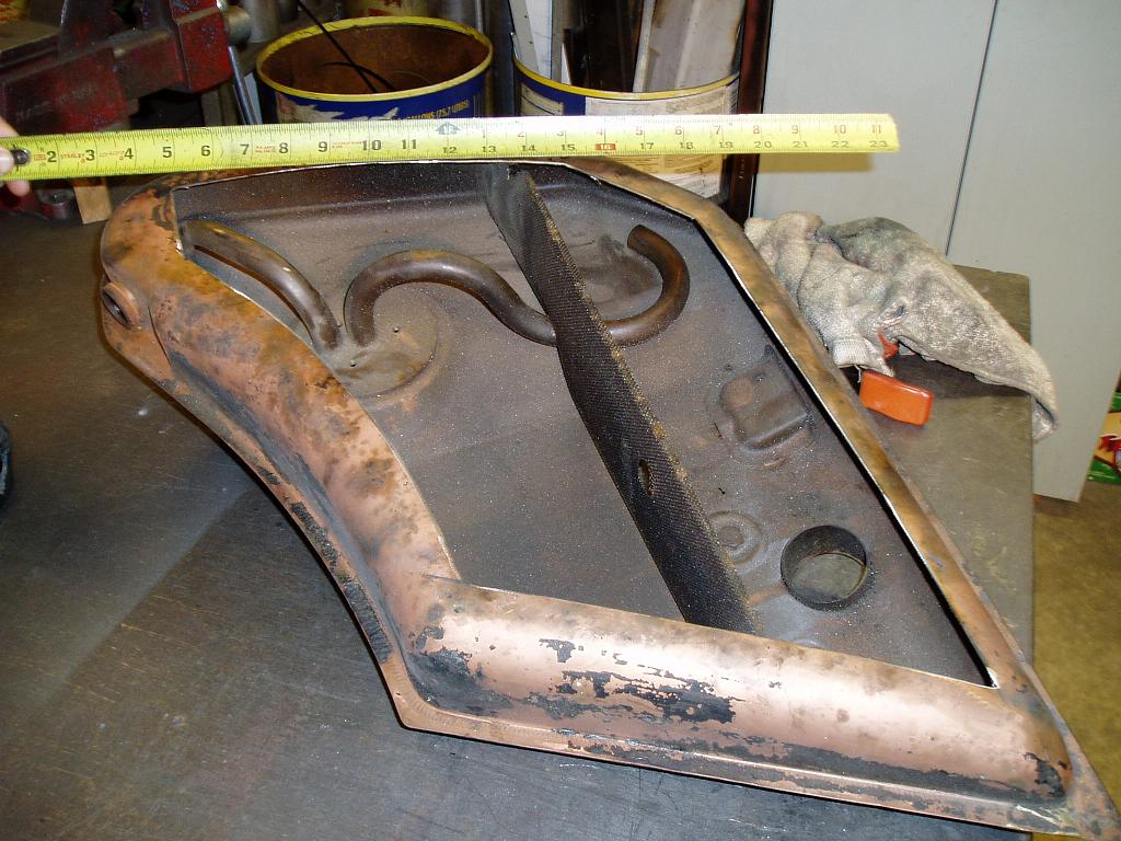

I tried uploading a 22MB file a few times, but it would time out.
Here are some pics of a tank someone cut up.
Attached ImageAttached Image
