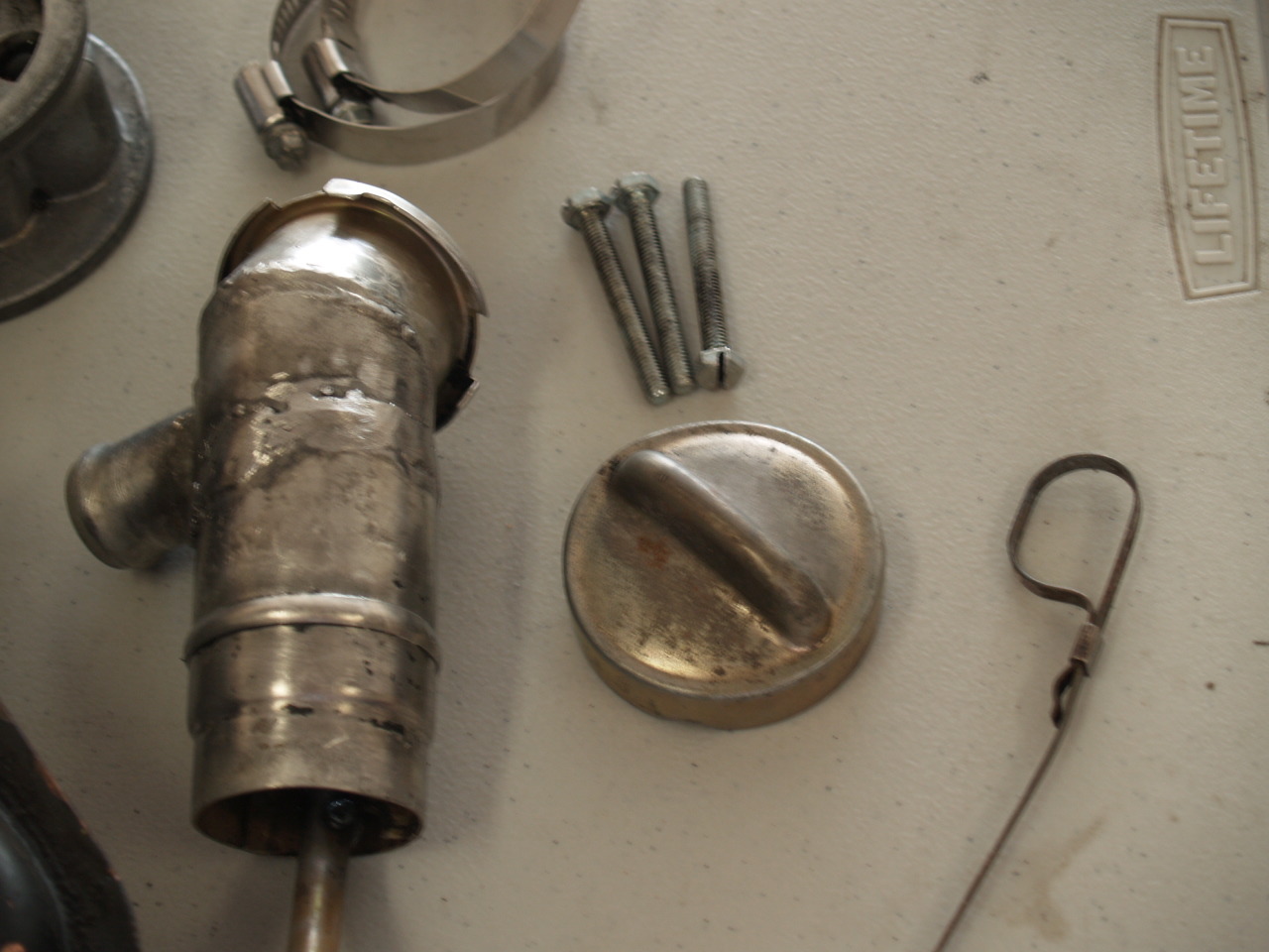

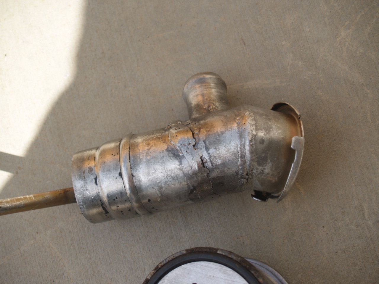

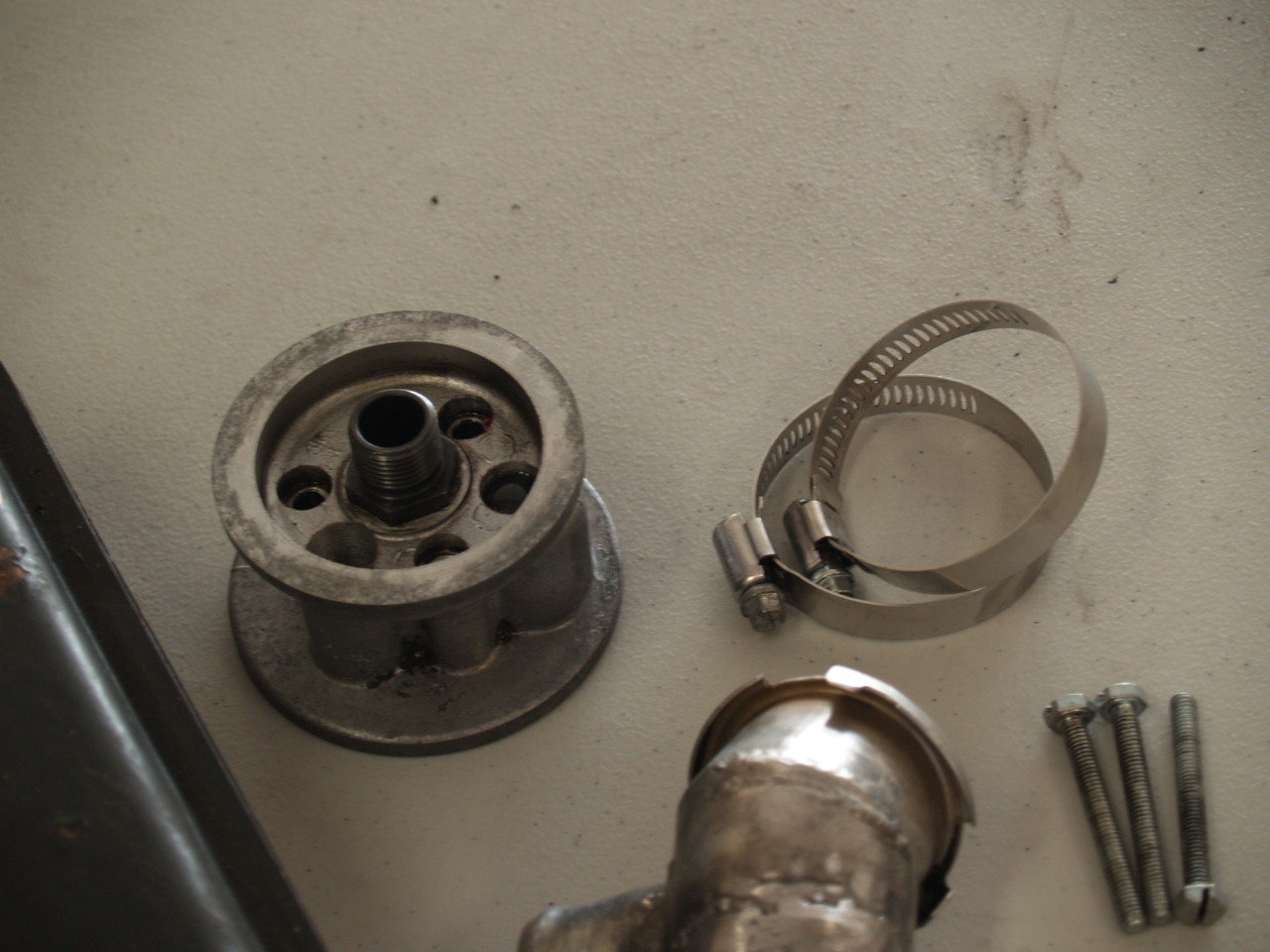

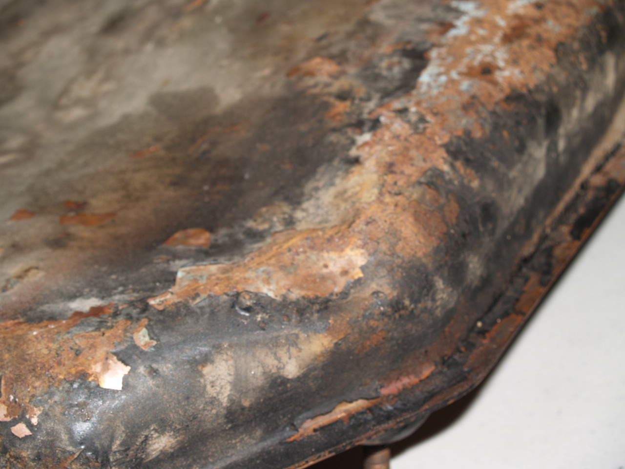

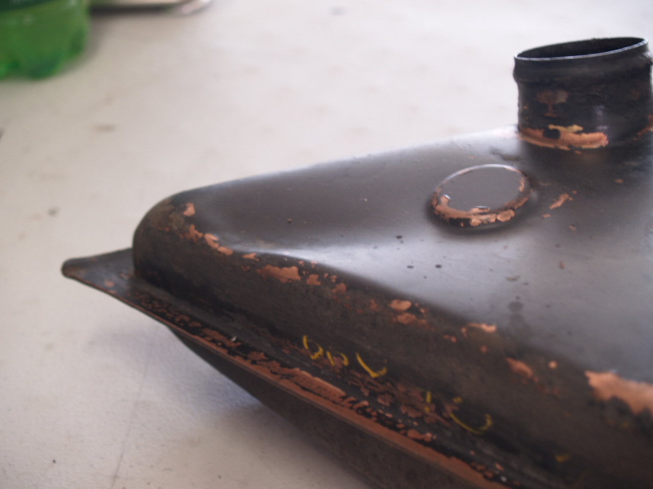

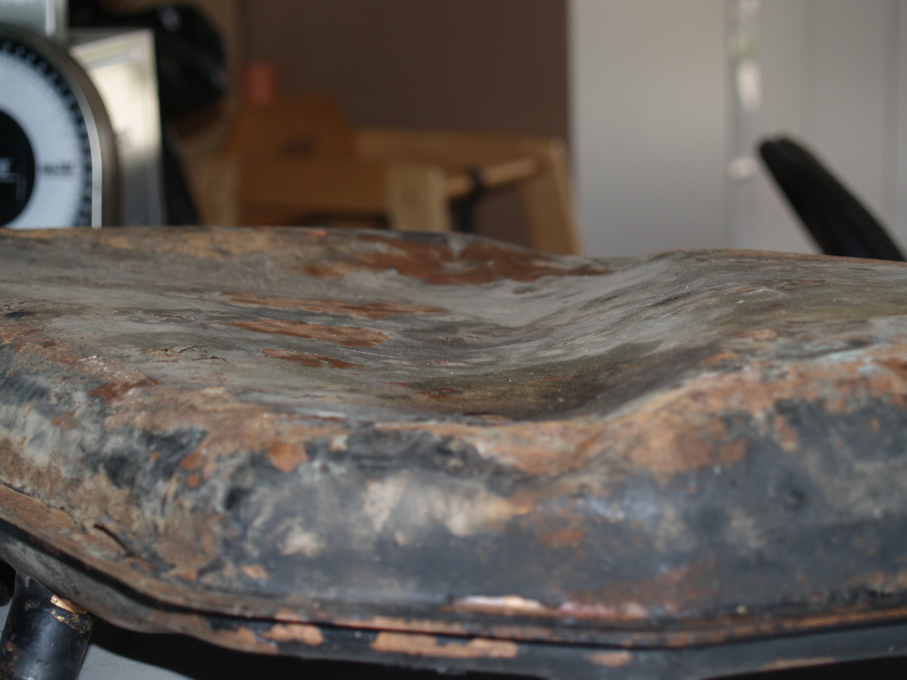

rick 918-S   I boosted these photos from someplace... :confused...   Aug 4 2010, 07:22 PM
