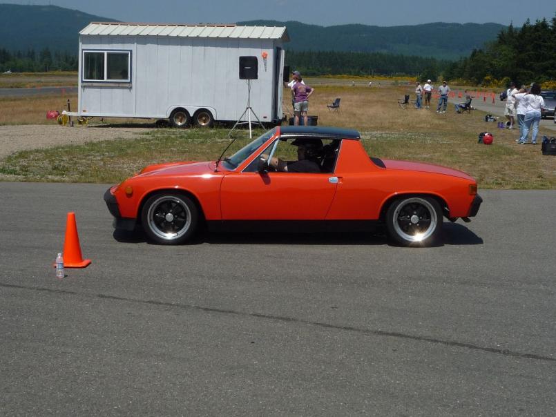

campbellcj   Bit of an older pic but these are 16x7's with ...   Aug 7 2010, 09:46 AM
qa1142   Bit of an older pic but these are 16x7's with...   Aug 7 2010, 01:21 PM
