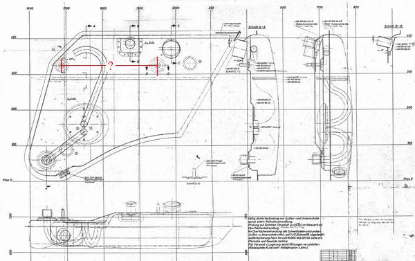

I'm hoping some one has a pdf of the oil tank dimensions. I want to build one like brant. Heck I'll send him a pm and see if he has them. If you've built your own or have the dimensions feel free to post them. Pics are good.

Can someone out there please get a center to center measurement of the mounting bolts. If the lines are indeed 100mm the print is @ 95% as downloaded. I've blown up the picture to have the horizontal grid lines = 100mm. Unfortunately the vertical grid lines are all over the map from 103 to 95 mm. If I can get this measurement I can build the tank.
On a side note the vertical grid lines give you the horizontal measurements and the horizontal give you the vertical.

jmill   Thanks Andy. Having build many aircraft parts usi...   Aug 6 2010, 09:19 AM
jmill   Can someone out there please get a center to cente...   Aug 7 2010, 11:15 AM

McMark   John, all 914 chassis are stamped with the 'bo...   Aug 7 2010, 12:55 PM
Eric_Shea   John... you can get that measurement from the in...   Aug 7 2010, 03:42 PM
