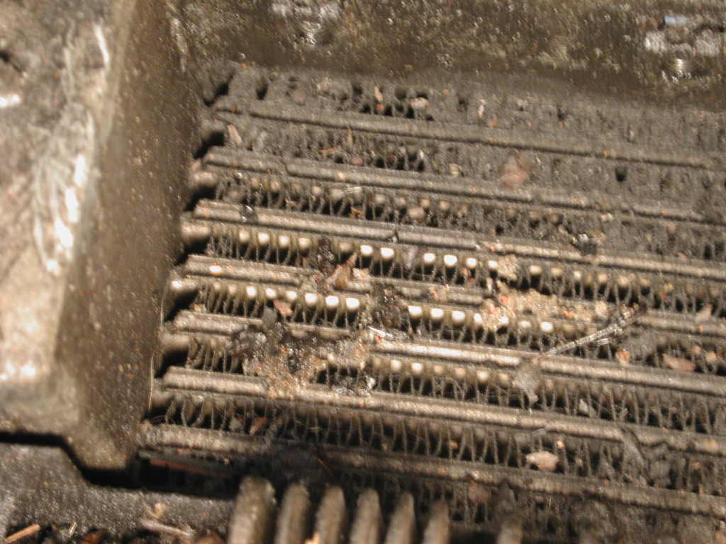

But I do have some final pics of cleaning the oil cooler with Brake Cleaner. This was suggested by Gint earlier -- my wrench said "be really careful -- it's very flamable and if the exhaust is hot you will not enjoy the experience!" I mentioned earlier that the brake cleaner may have messed with the exhaust -- I was totally wrong.
So here are the pics (before/after) of the oil cleaning exercise in one place.
First the before. For those new to this part, the /6 has a channel to funnel air from the fan into the top of the oil cooler. On an 914, it is visible on the top of the shroud from the fan, back to the rear of the engine on the driver's side. Oil leaks, or any other crap entering the fan, are well funnelled to the top of the cooler.
Before Pic.

krk   Nother before.   Mar 16 2004, 08:58 PM
krk   My cleaning approach: First I used a shop vac with...   Mar 16 2004, 09:02 PM
krk   Oops. The Pic!!!!!!! :...   Mar 16 2004, 09:03 PM
krk   And finally, for the really perverse -- you need t...   Mar 16 2004, 09:05 PM
