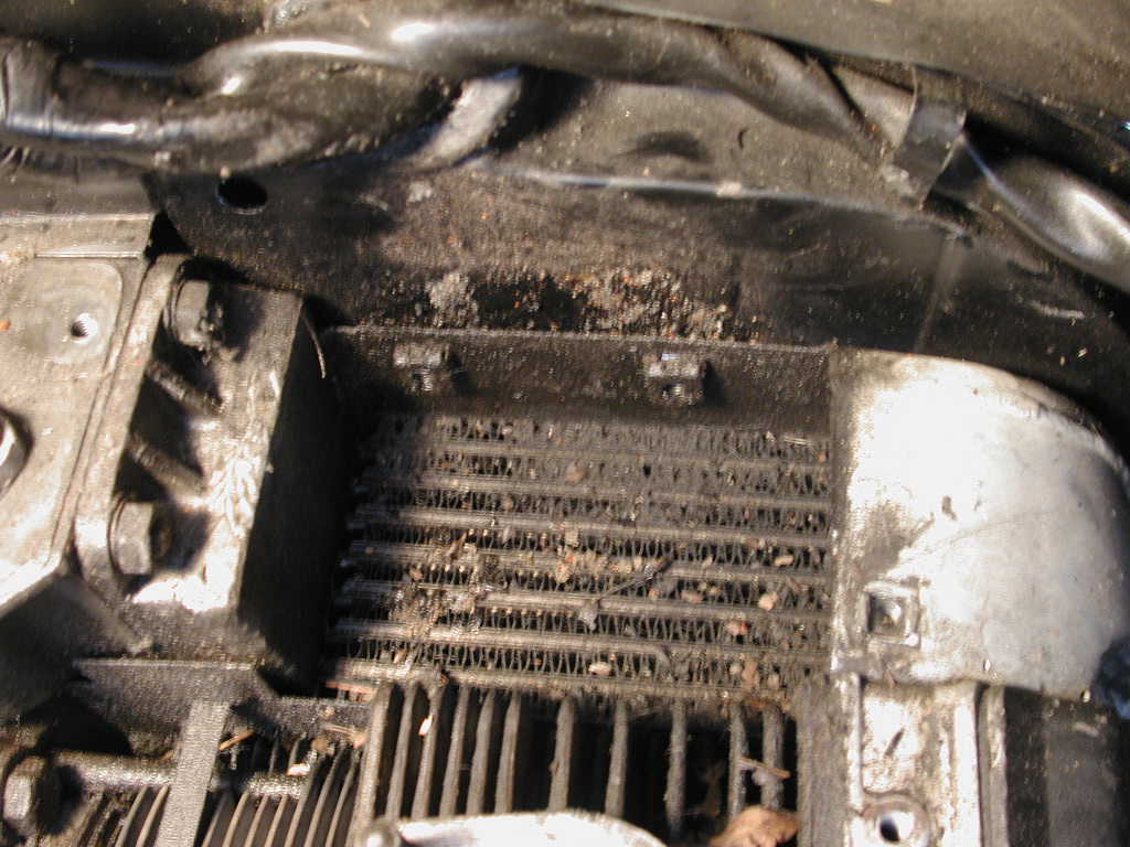

krk   The next thing I can see is that there is crap on ...   Jan 24 2004, 06:56 PM

J P Stein   OK, so what is the question? It appears that you...   Jan 24 2004, 08:20 PM

krk   JP: great point on the shopvac/fume issue. I...   Jan 24 2004, 08:50 PM
Gint   Put some plastic under it. Brake cleaner will eva...   Jan 24 2004, 08:53 PM

krk   My cleaning approach: First I used a shop vac with...   Mar 16 2004, 09:02 PM
