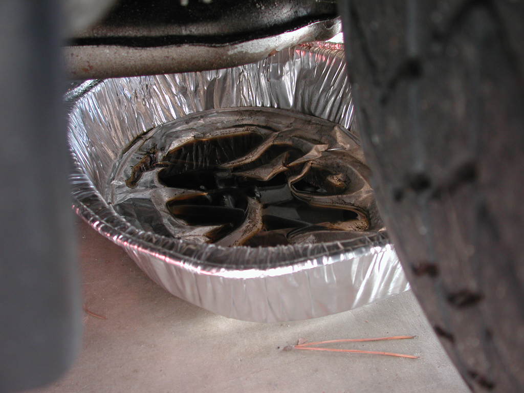

And finally, for the really perverse -- you need to see what drained out.
Here is the turkey pan.
I know -- nothing stirs the soul like someone cleaning old crap out of something. What a great way to end a thread!

krk   And you thought this thread was dead. Shame on you...   Mar 16 2004, 08:57 PM
krk   Nother before.   Mar 16 2004, 08:58 PM
krk   My cleaning approach: First I used a shop vac with...   Mar 16 2004, 09:02 PM
krk   Oops. The Pic!!!!!!! :...   Mar 16 2004, 09:03 PM
Carl   Well, THAT gives a whole new meaning to basting th...   Mar 16 2004, 11:35 PM
