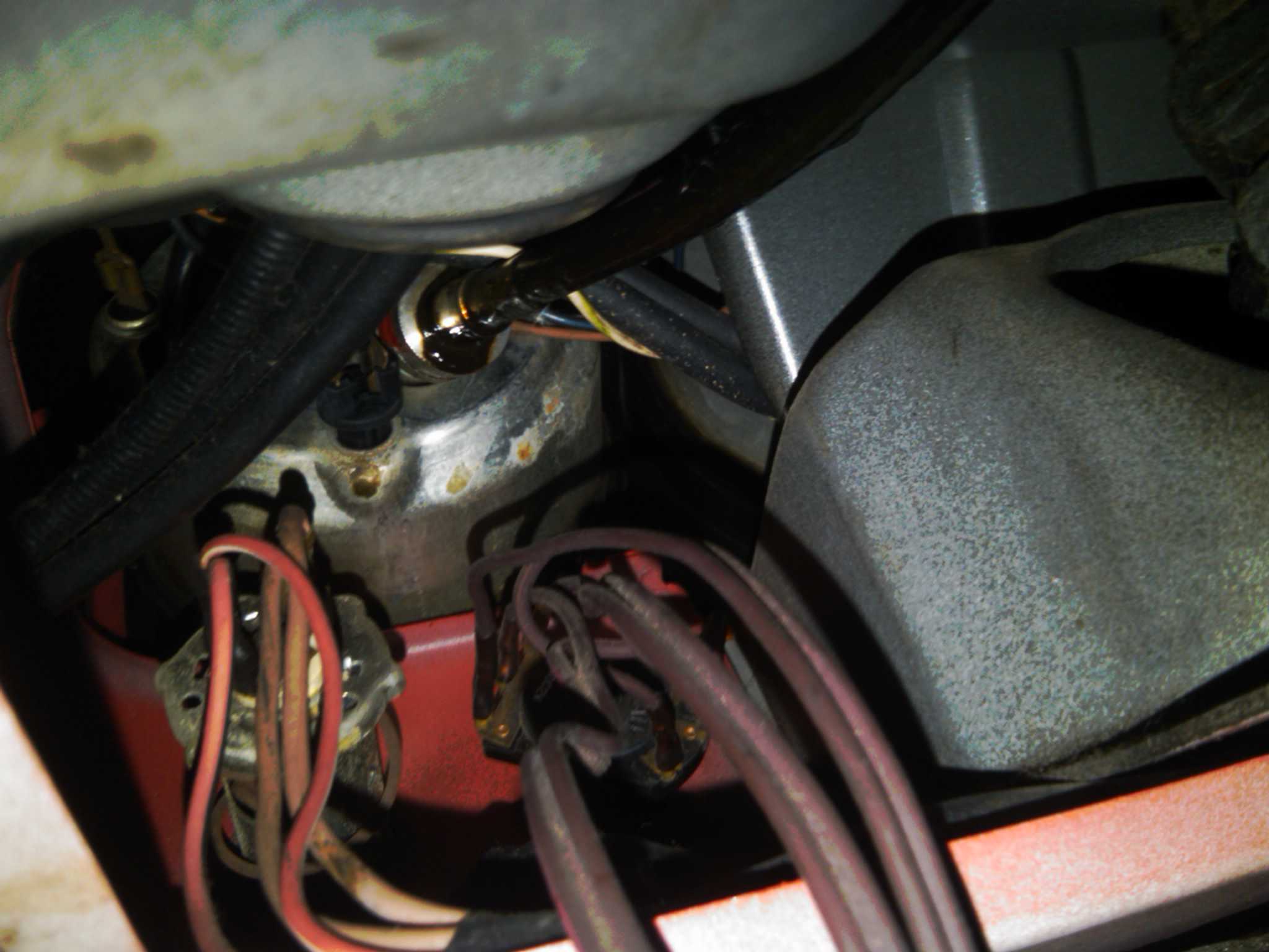

orthobiz   Concerning the speakers, it just looks like 2 brow...   Aug 10 2010, 03:25 PM

RJMII   I have brown wires under my dash like that; they g...   Aug 11 2010, 01:13 AM
