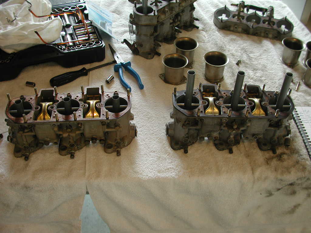

I have one last pic. There are old webers and new webers. The carb on the left is an old one, and the newer on is on the right. The tell-tale is the quality of surfacing that is done on the outside casting. Inside these carbs look pretty much the same. They got chinzy over time and the outer casting was left rougher.

krk   The clean carbs have worn throttle shafts. The di...   Jan 11 2004, 02:23 PM
