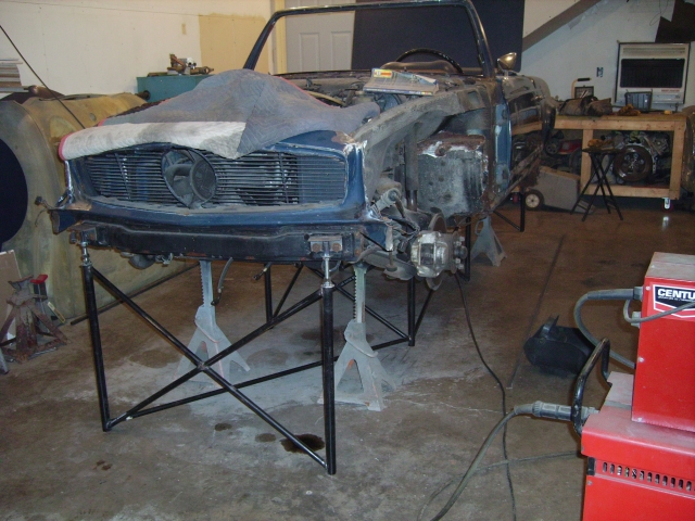

(IMG:style_emoticons/default/welcome.png) You have a real challenge ahead of you. The door gap is the least of your worries. I would suggest you build as solid a platform as you can. Along with the suspension pickup point fixtures you should add something like this front to back. I built this for a Mercedes that was about as rusty as your car with a prior improper repair that I was battling. I would attach all thread to it so you can adjust out any sag.

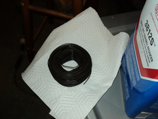

Which is by the way what I think is causing the gap issue on the driver side. I would take some tie wire and hang pieces about 12" long at both the right and left sides of the car in about 6-8-places. Longer in the front at the suspension pickup points and bumper mounting positions. Use known good places like the dounuts of they are still there, suspension bolts and bumper mounting positions.
Here's a quick and dirty example.

rick 918-S   Measure down the wire and set up a cross bar. ...   Aug 19 2010, 07:59 AM
