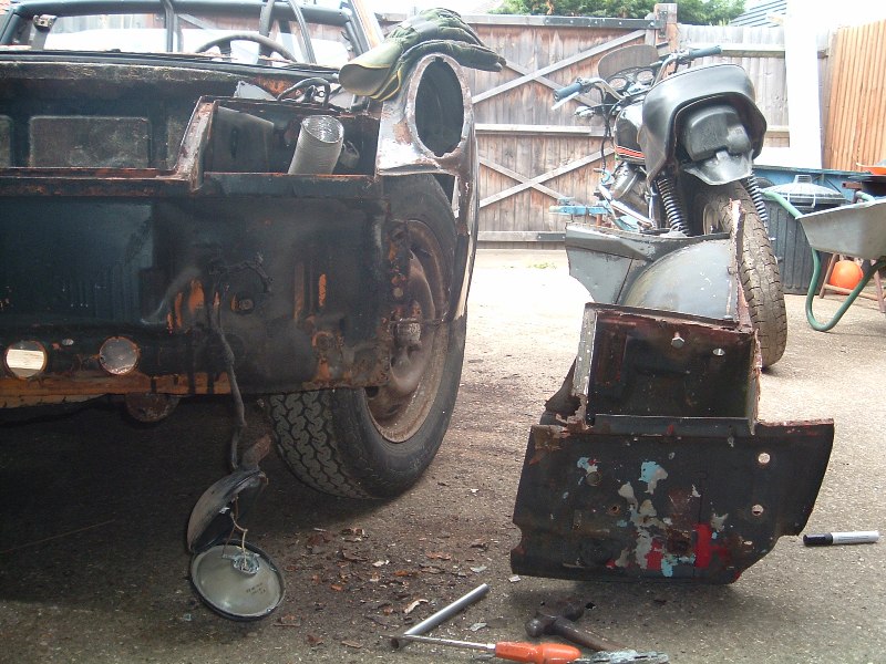

QUOTE(McMark @ Aug 18 2010, 06:06 PM) *
This looks like evidence of replacement. Better picture please....
Not had chance to take a better pic so here's another (bad) one from a few months ago of the area that you wanted to see.
All it shows is a big gap. I know I shouldn't have done it but enthusiam overcame ignorance and I drilled out the welds holding what was left of the outboard end of the valance to the wing and gravity did the rest.
There is definitely no evidence of a previous repair. The odd thing is that the other side is in a similar condition but nowhere near as bad which is what makes me think that the front end - and specifically the valance - has been pushed sideways and the flexing of the welded areas between the valance and the front wings has then lead to the corrosion. I've noticed this before - a smallish impact leads to corrosion in surrounding araes and joins. I'm guessing that the deformation - even if only temporary - opens up microscopic 'cracks' in the surface of the metal and allows moisture to get in and get to work. Any metallurgists here who can confirm that theory ?
When I've built my underframe jig I will then construct something off that which will give me a car centreline - then I can check whether the car is permanently turning a right hand corner.
