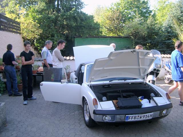

Here's one (not mine) that seems to high enough to clear the tank.
Cheers

elmonte   Here's one (not mine) that seems to high enoug...   Aug 23 2010, 05:27 PM
kfish914   It looks like they removed the expansion tank from...   Aug 24 2010, 07:11 AM
