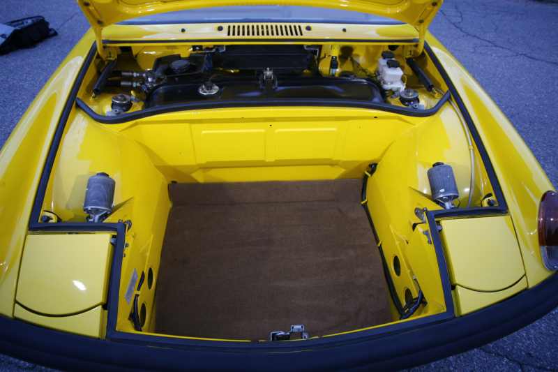

Wow Jack, that looks great !
With no spare, mine looks positively cavernous (I'm sure I could fit a few dead zombies in there).
(IMG:http://www.914world.com/bbs2/uploads/post-725-1277906065.jpg)
And to stay on topic, I do get a gas smell (from the car - not me!), but only on sharp left turns. Therefore I take three rights to go left.
