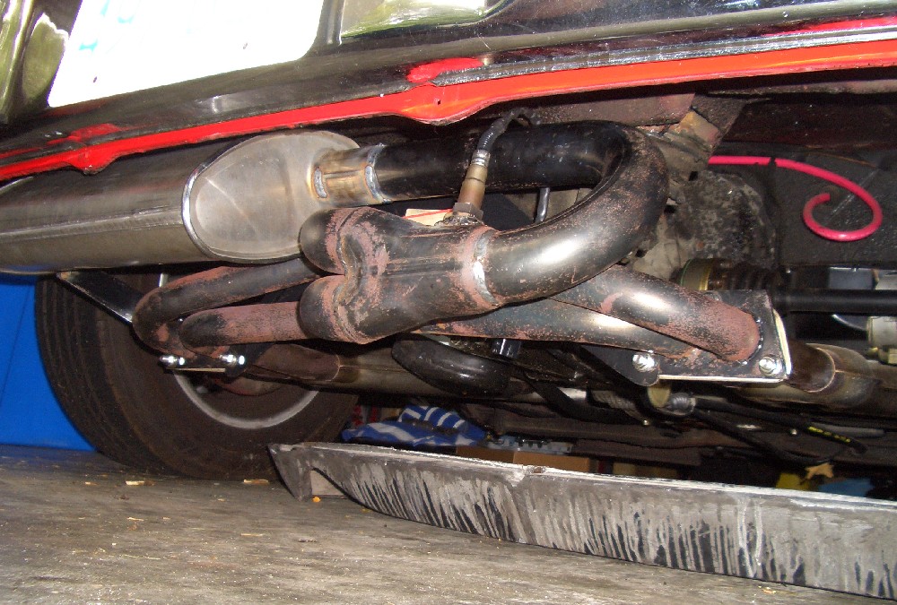

> Is this a good location for a wideband?

I have been having issues tuning my carbs. I finally decided to by a wideband air fuel package. I have searched and found several responses. I just want to triple check before I weld the bung. Is the area that is circled a good place to put the bung. I plan on putting it on the front side so it will not be noticeable from the rear- I just didn't have a picture of that side.

I've read from a couple of sources that you DON'T want a wide band too close to the head. That was true with the original O2 sensors, but the wide bands will fail really early if too close. Here's one article below on bung installation, recommending 1 meter (40") from nearest exhaust valve. Attached File  lsuinstal.pdf ( 205.15k ) Number of downloads: 179
Also, Here's where I put mine on my Bursch.

kg6dxn   Looks OK. You want it at the merge. The only probl...   Aug 24 2010, 08:52 PM
sean_v8_914   go to innovate web site and read o2 sensor install...   Aug 24 2010, 09:00 PM
charliew   Also put the sensor on the top to keep moisture fr...   Aug 24 2010, 09:01 PM

john rogers   The comment about on top is correct due to moistur...   Aug 25 2010, 09:38 AM
