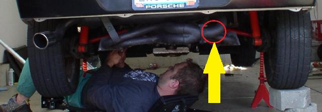

> Is this a good location for a wideband?
tornik550
post Aug 24 2010, 08:31 PM
Posts: 1,248
Joined: 29-January 07
From: Ohio
Member No.: 7,486
I have been having issues tuning my carbs. I finally decided to by a wideband air fuel package. I have searched and found several responses. I just want to triple check before I weld the bung. Is the area that is circled a good place to put the bung. I plan on putting it on the front side so it will not be noticeable from the rear- I just didn't have a picture of that side.

tornik550   Is this a good location for a wideband?   Aug 24 2010, 08:31 PM
kg6dxn   Looks OK. You want it at the merge. The only probl...   Aug 24 2010, 08:52 PM
sean_v8_914   go to innovate web site and read o2 sensor install...   Aug 24 2010, 09:00 PM
charliew   Also put the sensor on the top to keep moisture fr...   Aug 24 2010, 09:01 PM
tornik550   Thanks for the great advice   Aug 25 2010, 06:49 AM
john rogers   The comment about on top is correct due to moistur...   Aug 25 2010, 09:38 AM
tomeric914   I used Bosch 3 wire sensors and GM weather seal c...   Aug 25 2010, 12:58 PM
kg6dxn   I used Bosch 3 wire sensors and GM weather seal ...   Aug 25 2010, 01:33 PM
Cevan   I am in the middle of installing a WB myself. I...   Aug 25 2010, 12:19 PM
Cupomeat   :popcorn: :popcorn: I am very interested in your...   Aug 25 2010, 12:37 PM
Mark Henry   :popcorn: :popcorn: I am very interested in you...   Aug 26 2010, 06:00 AM
charliew   :popcorn: :popcorn: I am very interested in you...   Aug 26 2010, 01:31 PM
jk76.914   :popcorn: :popcorn: I am very interested in you...   Aug 28 2010, 08:12 AM
Elliot Cannon   I thought these things were used mainly with compu...   Aug 25 2010, 02:02 PM
Cupomeat   I thought these things were used mainly with comp...   Aug 25 2010, 02:08 PM
Dr Evil   I'll be wiring the one in the bus soon. :popco...   Aug 25 2010, 02:30 PM
john rogers   The question about needing one with carbs is a goo...   Aug 25 2010, 02:42 PM
jk76.914   I've read from a couple of sources that you DO...   Aug 26 2010, 04:27 AM
tornik550   I've read from a couple of sources that you D...   Aug 26 2010, 06:54 AM
Mark Henry   11 is too rich, best power and cooling on an airco...   Aug 26 2010, 02:00 PM
sean_v8_914   the innovate is fast. It can sample each individua...   Aug 27 2010, 09:10 PM
